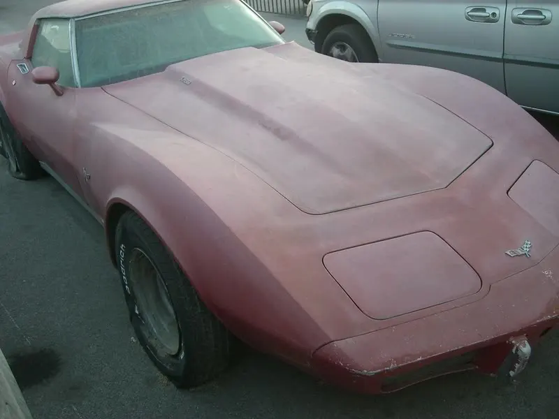

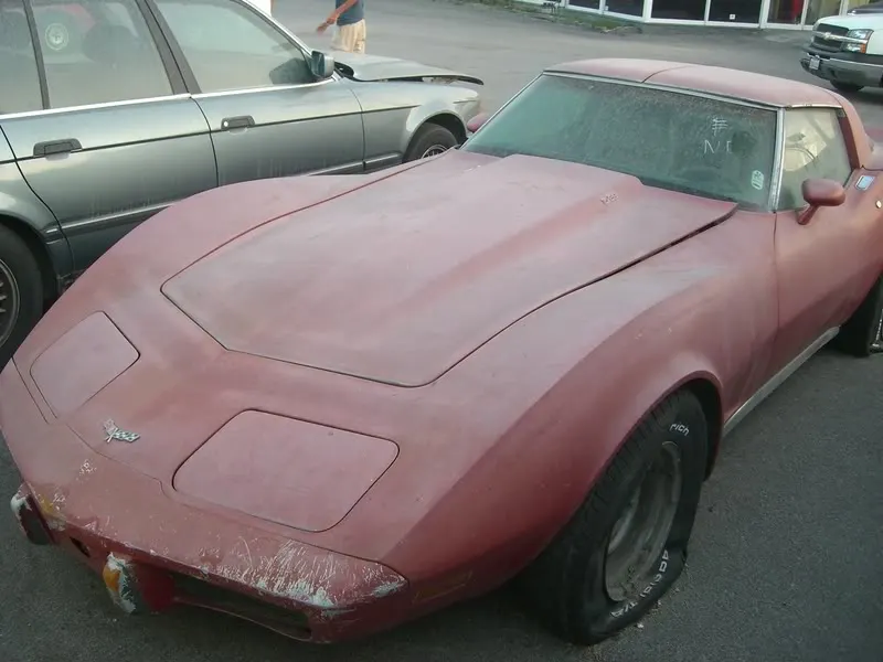

Well, I turned the vette down, after looking at it, it wasn't worth it the time, and effort that would be required to get it running and looking good again. These are the pics.
All four tires are shot and crumbled, there are no keys to the car, the fiberglass is cracked all over, it hasn't moved for 5 years, it hasn't been registered for 21,. BUT!!! It has an L82 engine in it. (L82 350 V8 225 bhp.) That is at least what the emblems say, because the car doesn't have a set of keys I couldn't open up the hood to make sure. Even if it did have that engine I doubt it is worth taking out who knows how many year old oil, and other fluids.
Maybe if I wasn't about to go to college, and had some room in the garage, I might have considered this project

A couple things to add to rbohm's list: Chevy's don't have an oil pump drive shaft. :D That item's part of the distributor. ;) And instead of rotating it one revolution, you need to go at least two full rotations to cycle the valvetrain. Four revolutions is better. As for oil in the cylinders, I just pour a whole quart of auto trans fluid down all of the cylinders. Then let it sit and after rotating the crank several times, I let the starter clear the oil out before replacing the plugs.:nice:
That doesn't look that bad. (I'm also in the rust belt.)
The no keys part is a raw deal. (It is kind of like a take it home and see what you get suprise!) But since it is a total tow it home car, yeah that can be a pass with no keys.
Yah, I just don't have time to do all the work myself, so I just emailed USC (my college next year) and asked if their racing team would like to setup a new restoration program. (kinda hard for a freshman to go about and do it but let's see what their reaction is) I think it'd be awesome to get this car running (especially if it has a L82 engine in it) and paint it usc colors and then be able to auction it off or something. The guy who was giving it to me was willing to tow it to our house but we stopped him at the last minute. Hopefully this usc thing will pull through :D
