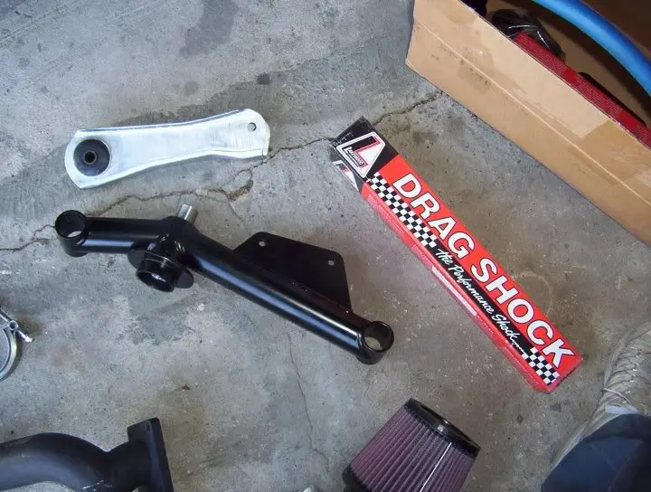

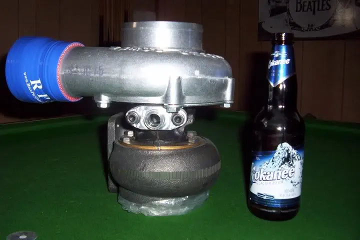

sort of a home made kit cause i'm making the cold side and the section of downpipe that connects to the mufflers
heres a run down of my motor N/A
306
Twisted wedge heads
track heat intake
track heat cam
1.6 roller rockers
3.73's
super turbo mufflers
U/D pullies
etc.
the turbo setup
MP T70

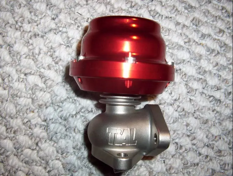

tial 38 mm wastegate
Ebay BOV

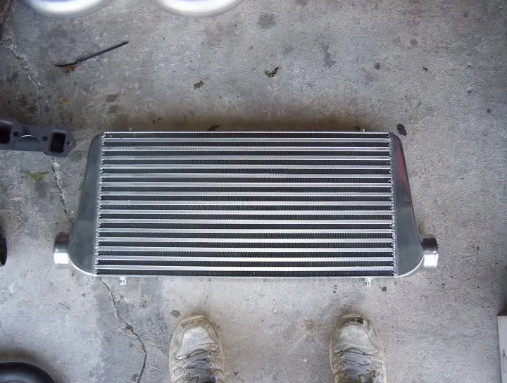

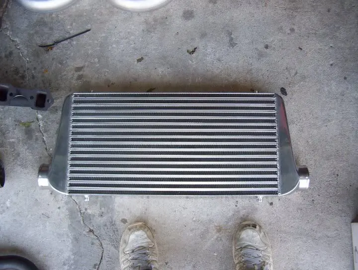

Ebay 24x12x3 Intercooler
B&G hotside and downpipe
homemade cold side
other stuff i'm installing at the same time

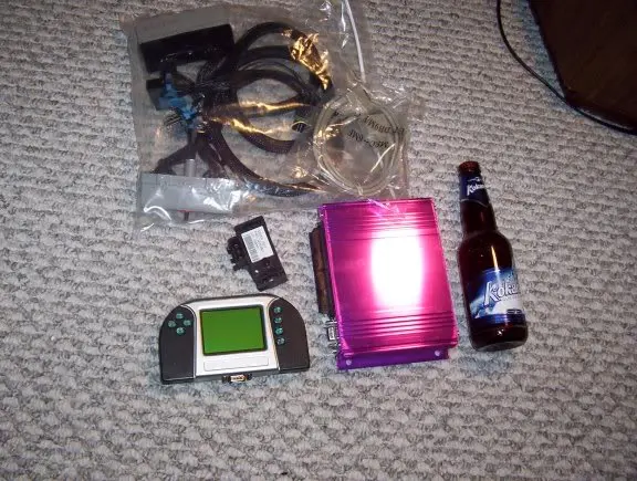

MSD 6AL
anderson ford motorsport PMS
42 lb injectors
Pro M mass air meter
Pro 3i adjustable lower control arms
ford racing Upper control arms
lakewood 50/50's
summit battery relocation
some pics

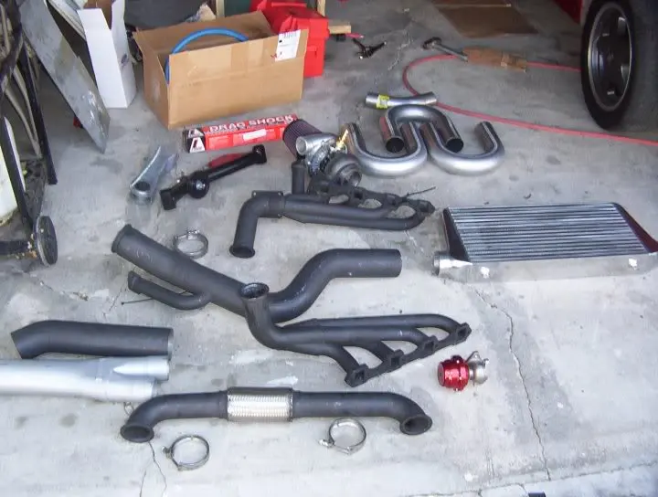

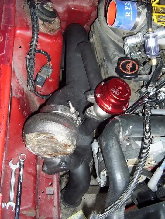

this is where it will bassically sit, i had to do some "massaging" to get the downpipe to fit properly (big hammer) so this is just kinda mocked up

lol ya i didn't feel like taking everythig out of the box the bushings are around somewhere.

What kind of turbo is that? Is that the same one that comes in the pony down turbo kit. I think the kit is around $3000. I was looking to put a single turbo kit on my car in a year or so, and was wondering if the pony down kits were good.
track heat cam... i'll grab the specs later, or you can look on trickflows website
total i have paid for the turbo minus the PMS and MSD is about $2200 canadain so like $100 USD :D :rlaugh:

got a abit done last night on the down pipe but my sister stole the camera (actually its hers so i steal it) i'll post pics later after i have more done tonight.
