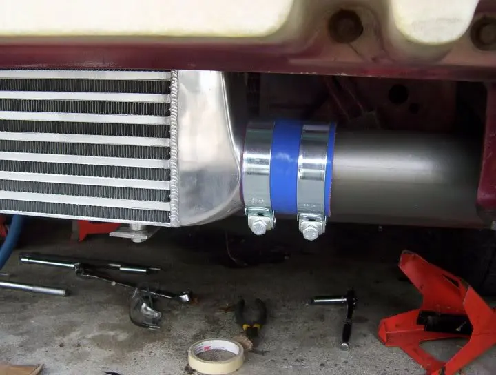

got some work done on the coldside, i just need to pick up some t-bolt clamps and then weld up the seams. we are gonna mount the rest of the down pipe on my buddies hoist at work

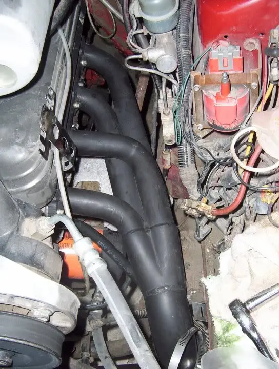

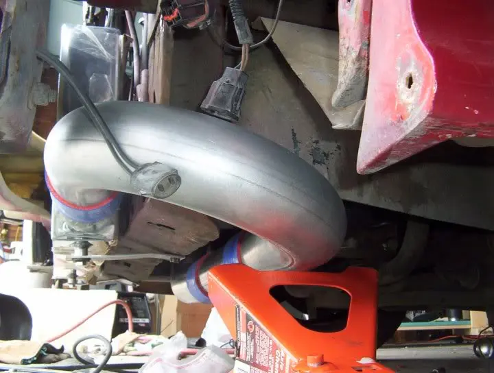

drivers side header

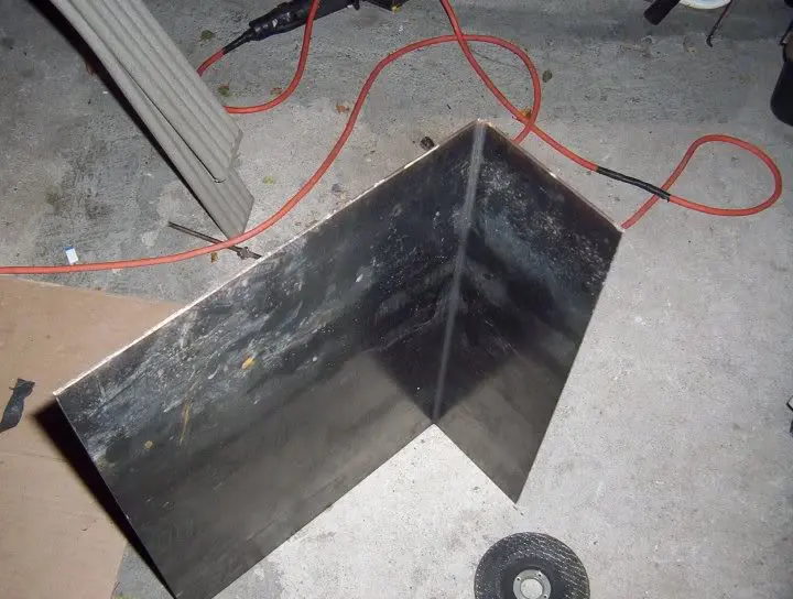

Crossover

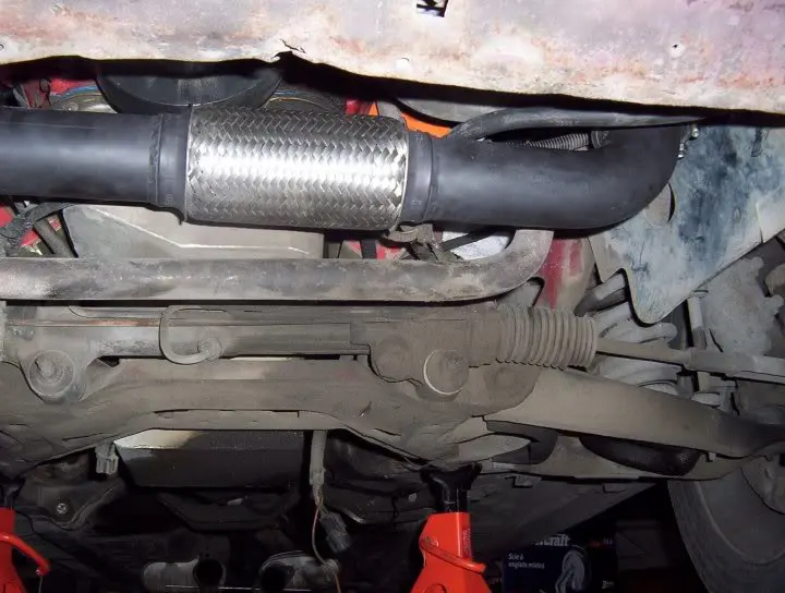

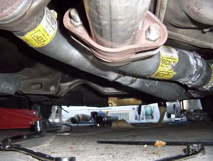

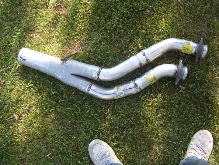

section that connects the downpipe to the catback (doing this part on a hoist :D )

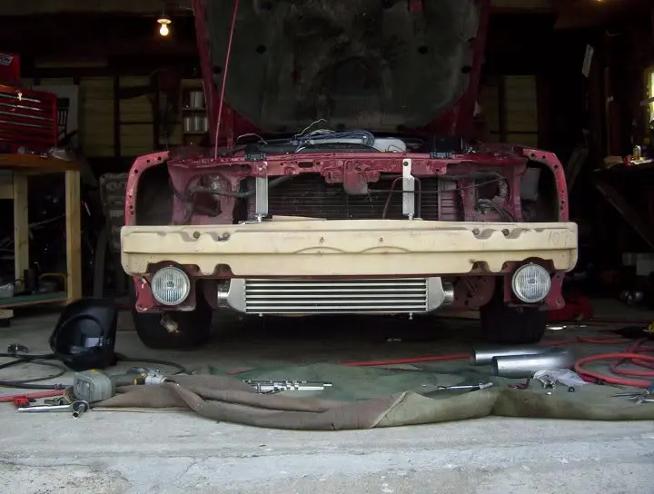

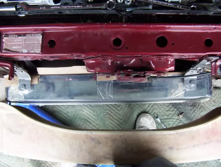

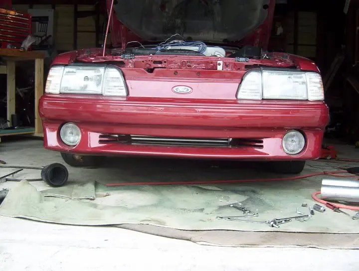

intercooler mounted, some of the these intercooler pics look crooked cuase my driveway is uneven and the car was jacked up in most of the pics

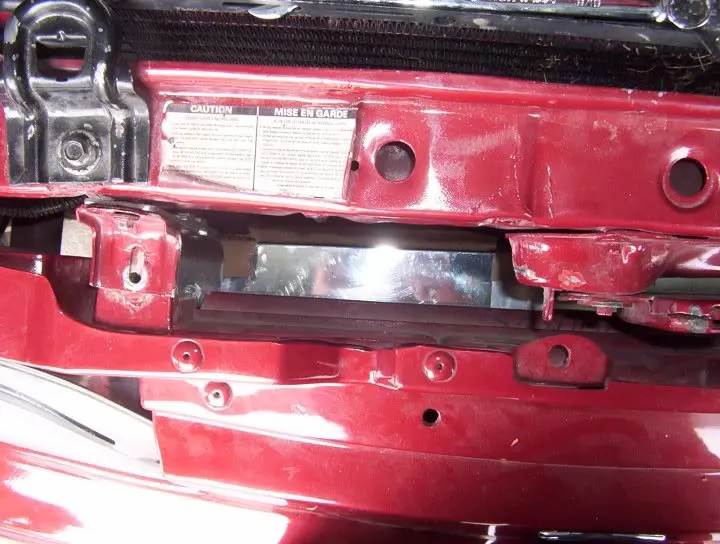

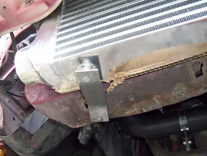

close up (you can see where i made the brackets bigger cause my dumb ass cut them before i made sure the bumper fit on)
bottom brackets

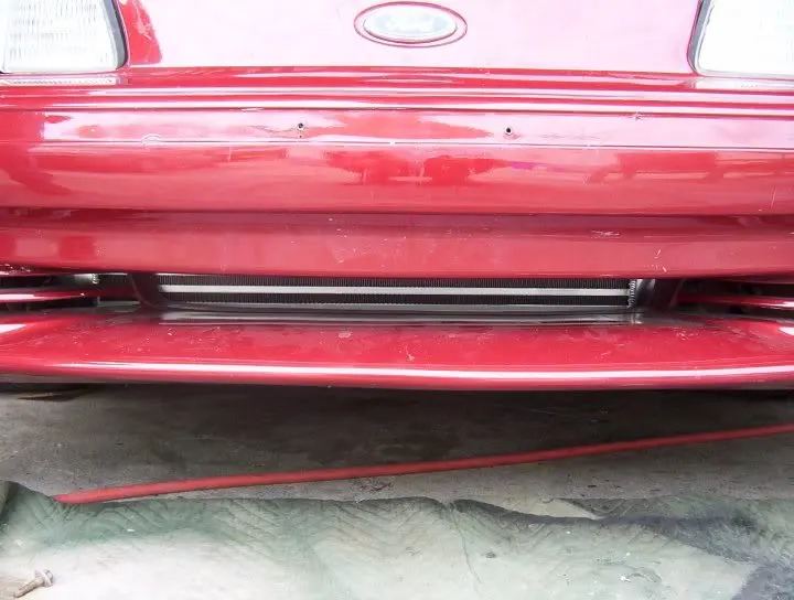

with the bumper ( bassically no hacking required)
close up
looking down with the bumper on

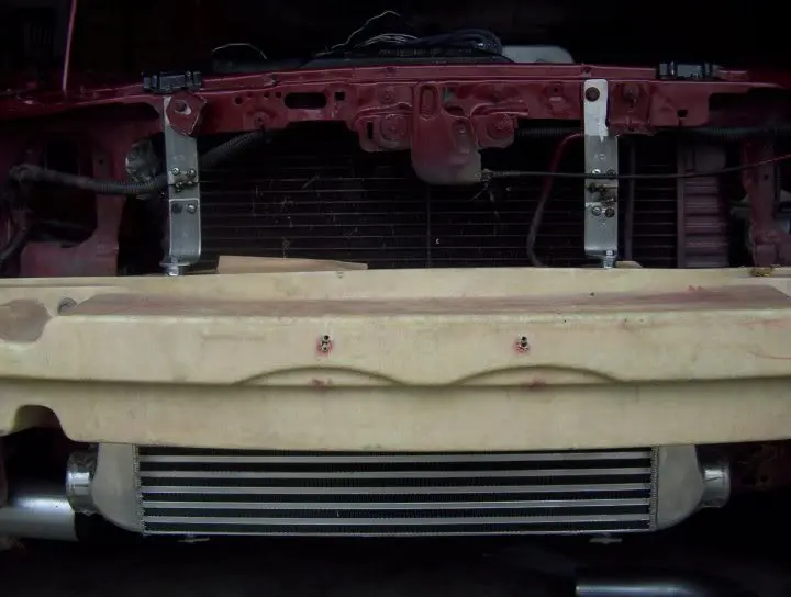

looking down with no bumpe you can see how much room there is behind there

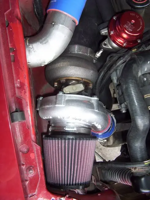

turbo in place

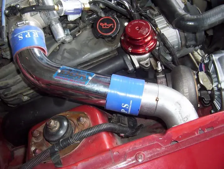

Throttle body piping (put my old cold air kit to good use :) )

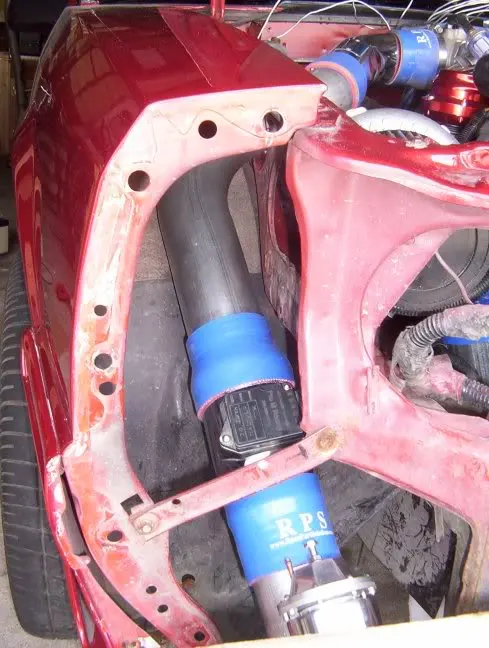

passenger side in fender piping, you can see my mass air meter and BOV
drivers side piping

got my cold side painted
picked up my t-bolts

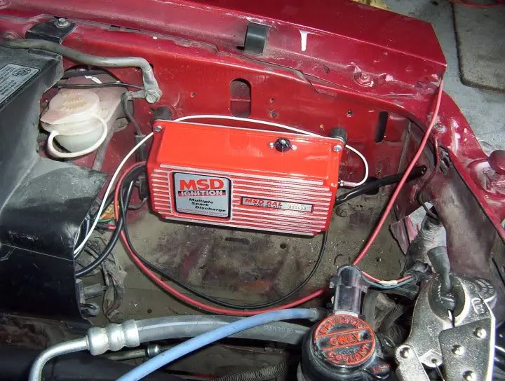

istalled my MSD box where the battery used to be

couple pics of the coldside painted with T-bolt clamps, my MSD and PMS mounted. i just gotta run the cable from the trunk for the positive and it should fire up. but now i realized i need to buy some better drain hose and a 45* fiting or else this thing ain't gonna drain
some pics to hold you off till i get it running not much but its something
MSD in place

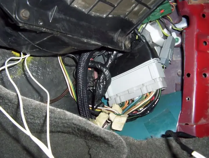

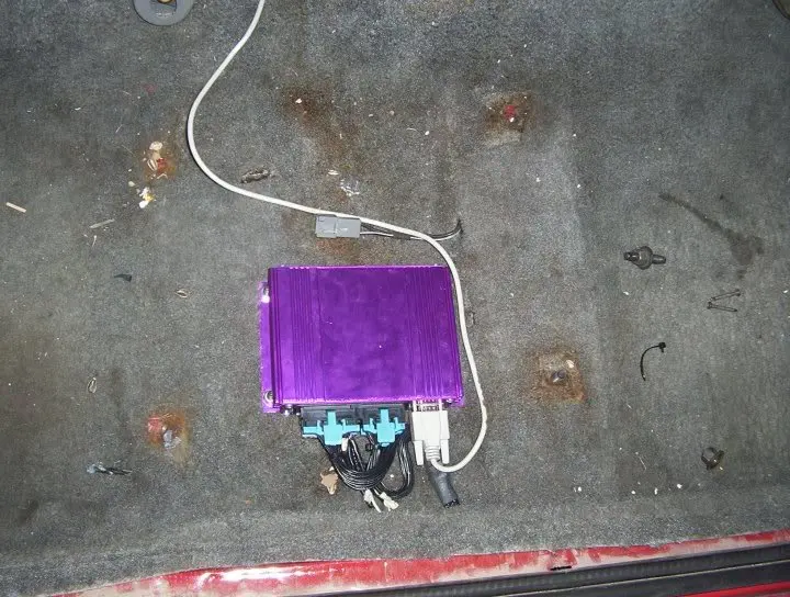

PMS under passenger seat. i know my carpets are dirty too ;) (white wire goes to the hand held controller)
it was a bitch to get the piggy back harness to fit in here
cold side all buttoned up

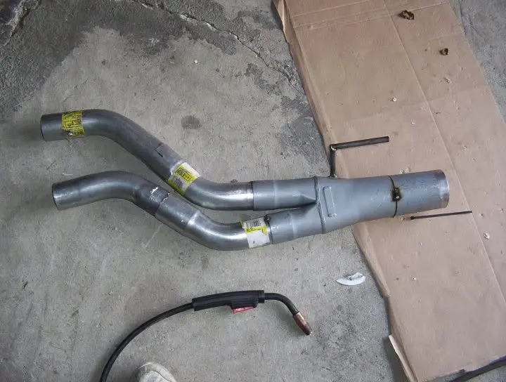

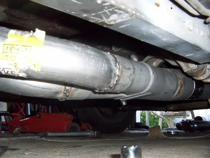

i learned my buddy (who i borrow the welder from) is a much better welder lol. plus the gas was giving me trouble but i got my "catback connection" done and I should fire it up tommorow....... but ive said that before
midpipe
mounted....no smartass comments on my ****ty welding lol, igave my welder the day off lol
