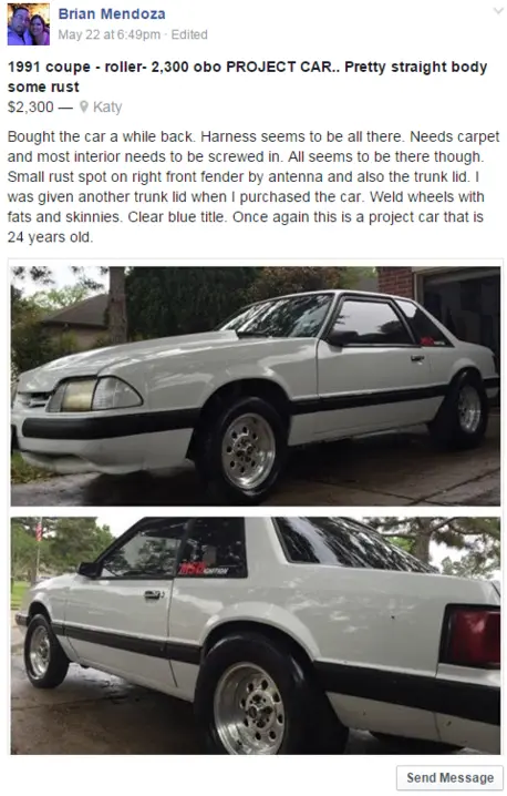

Talk this guy down some. It's in your back yard.
