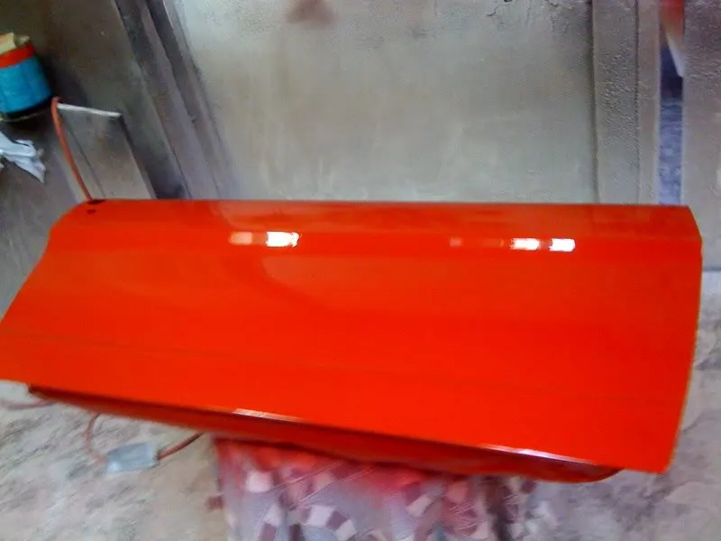

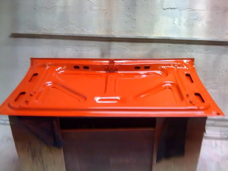

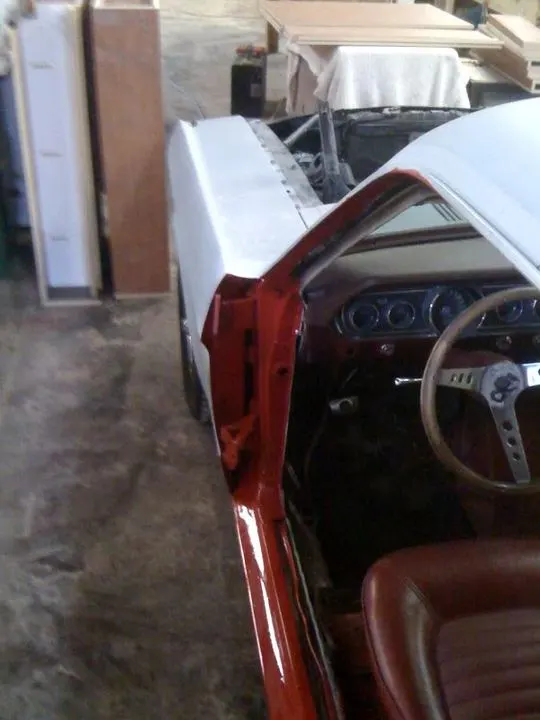

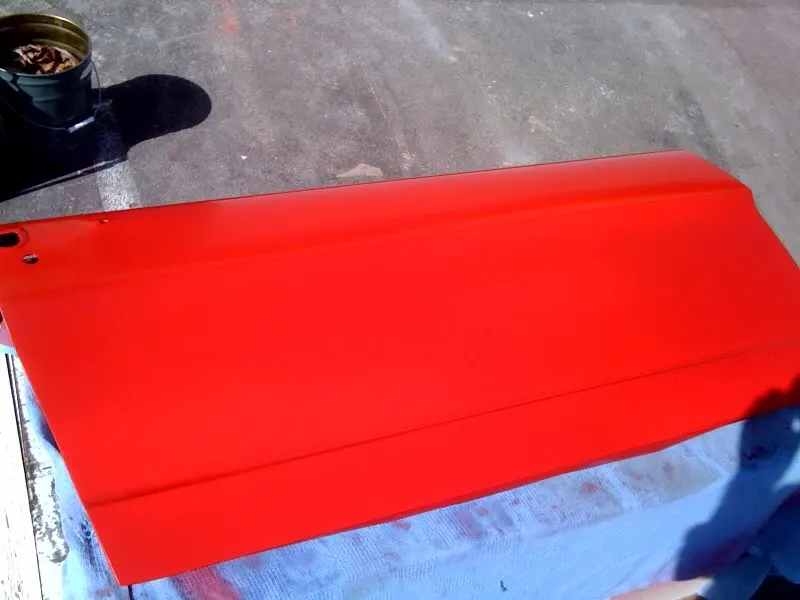

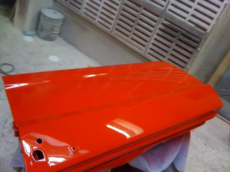

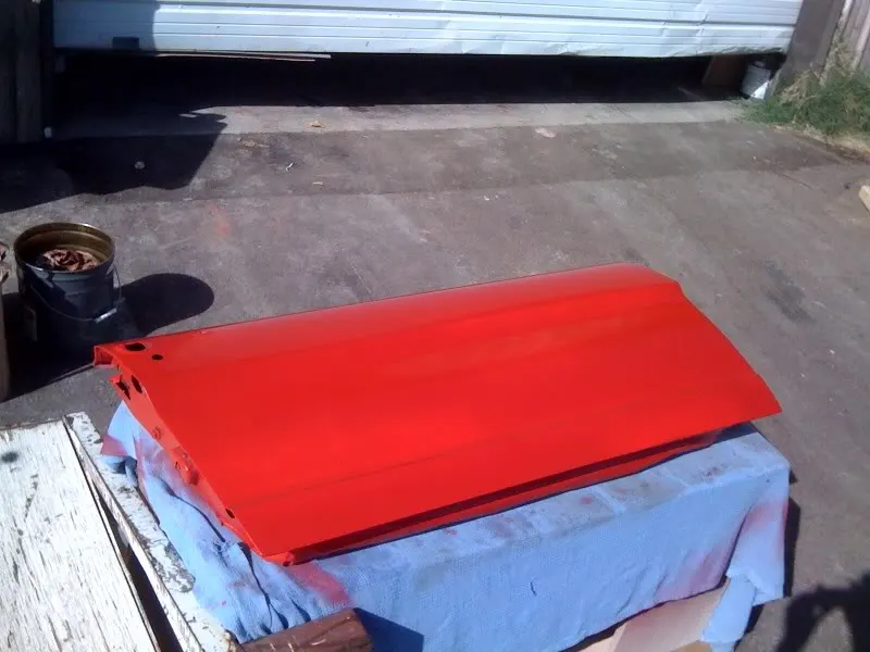

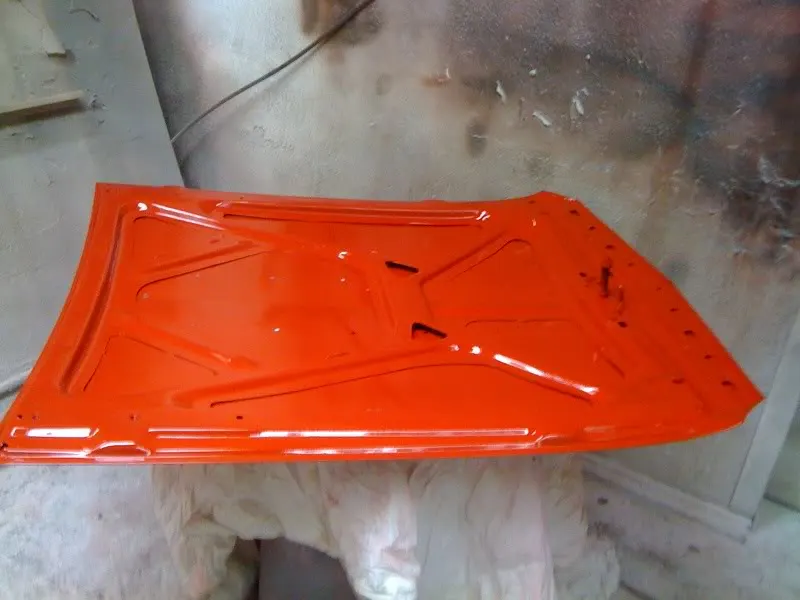

Hey guys its been a LONG time since ive posted on here and i figured i would start with some progress. I finally started doing the paint on my car and wanted to share a little bit. Some of these pics are before clearcoat and not all my base coats are on, and then the others are after clear and before color sanding and buffing which im doing in the morning and ill post some more pics. Well here you go guys, the color looks alot more orange in these than it is in real life since its a cellphone pic. Ill try to get a real camera in the morning to take pics. :D
If you wounder why i did the doors and jams and underside its because i wanted to make sure everything worked out well and if it didnt i did not spray the whole car. I had a little bit of contamination when i sprayed it but sanded it out and it turned out pretty nice, i think. The car has been my daily driver for about a year since i primed it, so i guess the contamination is expected. Does anybody know if i can do anything to get rid of that besides grese and wax remover. Well hope you all enjoy

Thanks alot for the advice. I got the one door wet sanded and buffed out and it looks really good just some swril marks I need to get out, but virtually no orange peel :) and it's straight. Although while driving it (it's my only car) someone put a chip in my paint already :/ oh well it can be fixed. And as for the advice thanks a ton. I will have to get a tyvek suit when I spray the rest of the car. Work on it is a little slow with my academy and such but I'm making progress.
