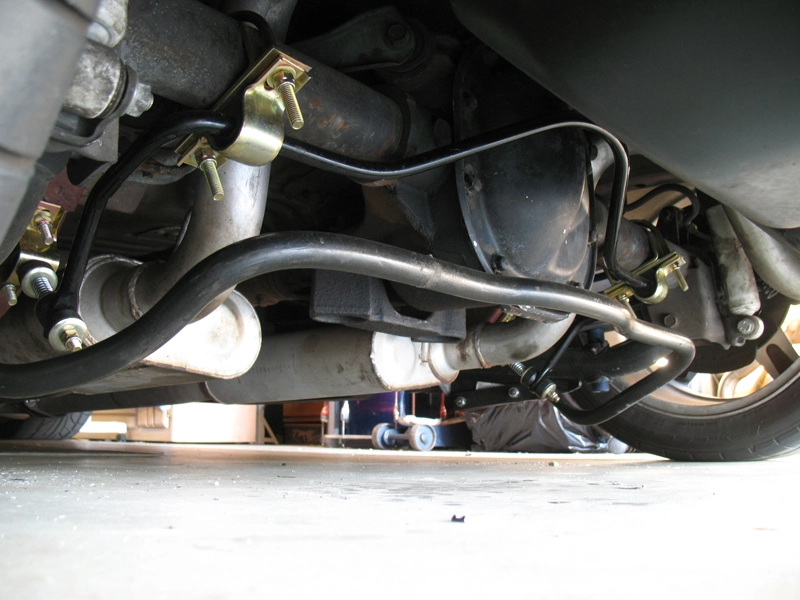

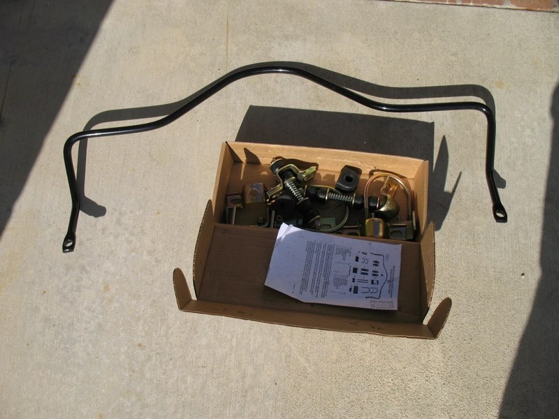

about a week ago i did my install for my Steeda Adjustable Rear sway bar. Since then i have spent alot of time in the canyons new my home testing out the new bar and getting the adjustment set. The bar made a very nice difference. Its very hard to get the rear end out now. Its grips hard in the rear. Teamed with the Cobra Rear Bar (Which is the same thickness as the Eibach or Steeda HD Bars) it give great stability. I dont think i will ever have to change the settings on the bar because i tune my suspension on a canyon road which is pretty much very close to the way the corners are at the track usually go to (Street of Willow at Willow Springs Raceway)
I am signed up for a Trackday end of February and a Auto-X event mid February....should be fun to see how the bar works out.

I just bought the Steeda adjustable, getting it installed next week. Gonna be using it with the stock GT bar. What settings are you using with the Cobra bar? Is it easy to get in oversteer mode if you adjust too much?
Two sway bars :scratch: Never noticed that the setup was like that :shrug:
Now go straighten the passenger side muffler!

Yes, i use 2 wrenches. A Combination Wrench on top and a Socket drive on the bottom. I installed the bar kinda loose at first but then after i realized how it effect the car i started tightening up. I may tighten it more soon. I want a little more oversteer :D
