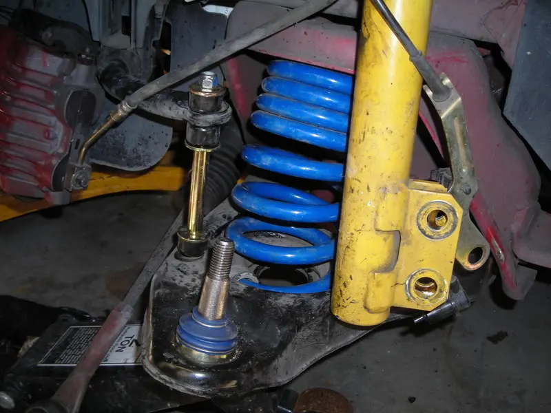

Steeda bump steer kit & X2 ball joints. Finally installed!!! Pics

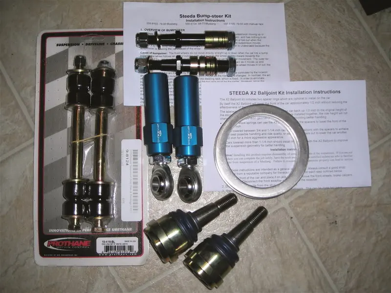

I am getting ready to install a a steeda bump steer kit, X2 ball joints, & prothane poly end link bushings tommorrow. With the mods in my sig, how much am I gonna notice the difference after I install these. At this point my suspension & steering feels pretty good, and the handling is pretty decent, but I am hoping this will give me better steering response and cure some, or hopefully most of the bumpsteer. And also if anyone knows a reputable alignment shop in the Sacramento, California area that will know what to do when I bring my car in for an alignment. Or are the bumpsteer kits easy enough for any shop to work with. Most of the regular alignment shops hate doing lowered cars, and they wont set my camber & caster settings to the specs I want.

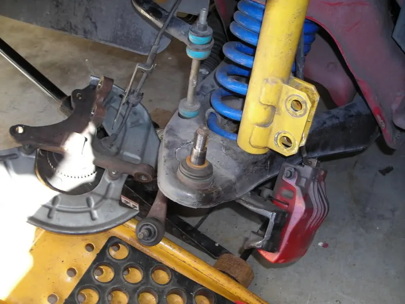

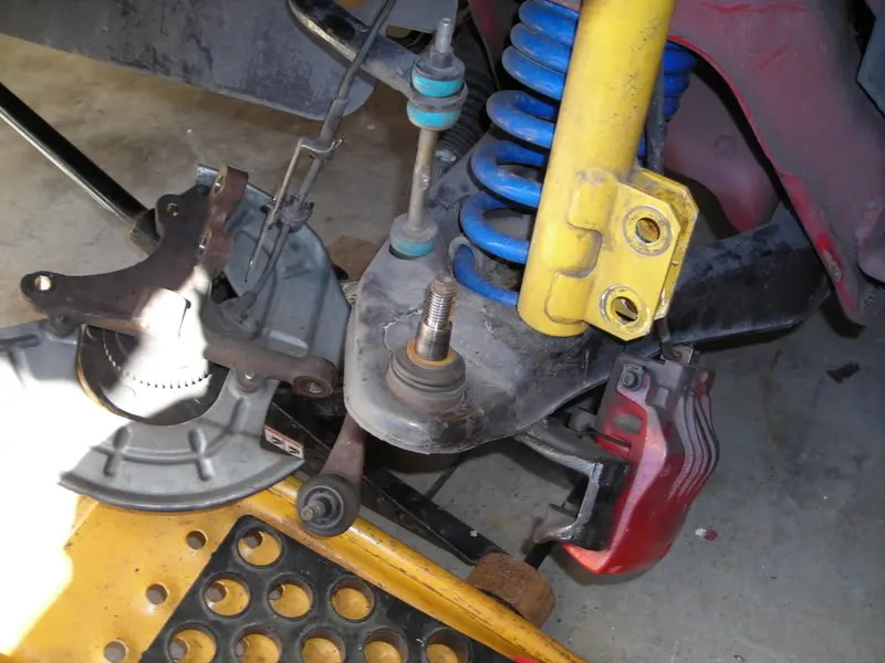

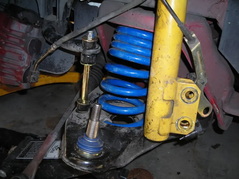

So I finally installed these 2day. It wasn't as easy as I thought it was gonna be, but it wasn't that hard either. Certain things are just a b--ch when you dont have a lift or all the right tools. Getting the old ball joints out probably took the longest. Luckily I had my freind who is a tech for dodge helping me out. Here are a few pics during the install...
With the old balljoint still in

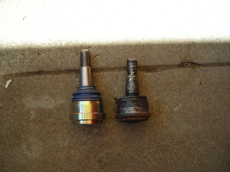

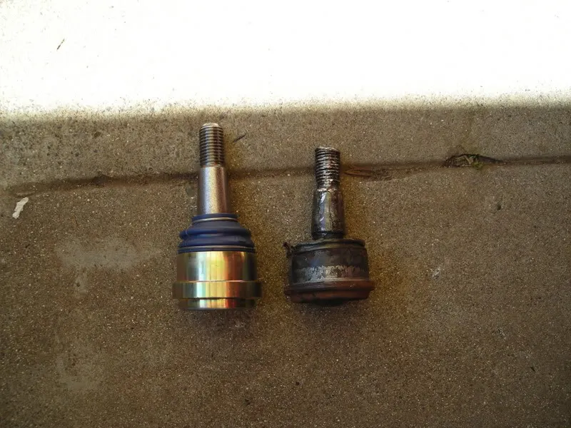

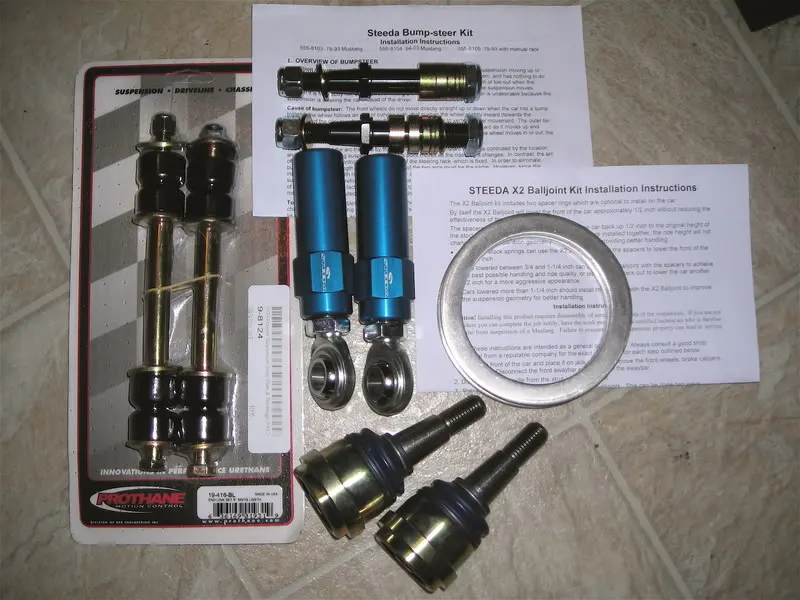

Here is a comparison of the 2. The old one took a major beating from the hammer

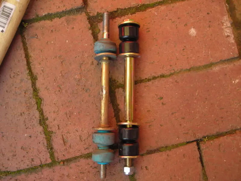

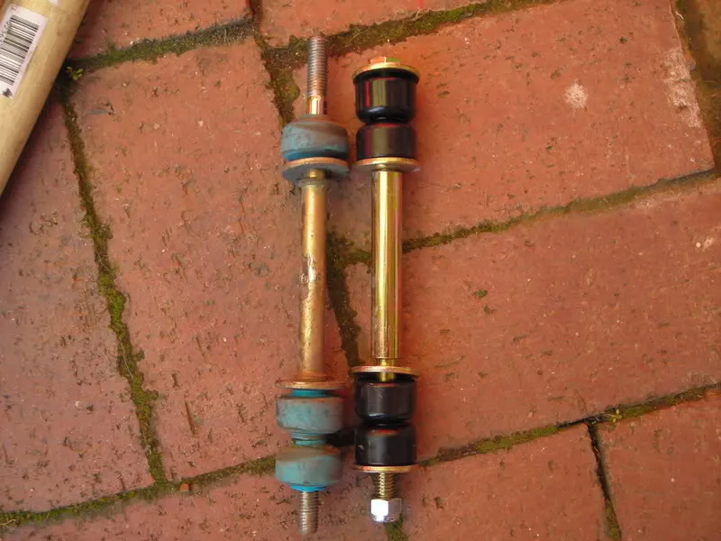

The old & new end link
The new end link & X2 balljoint installed

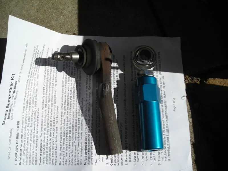

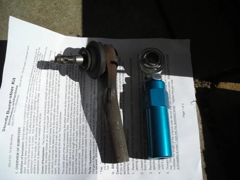

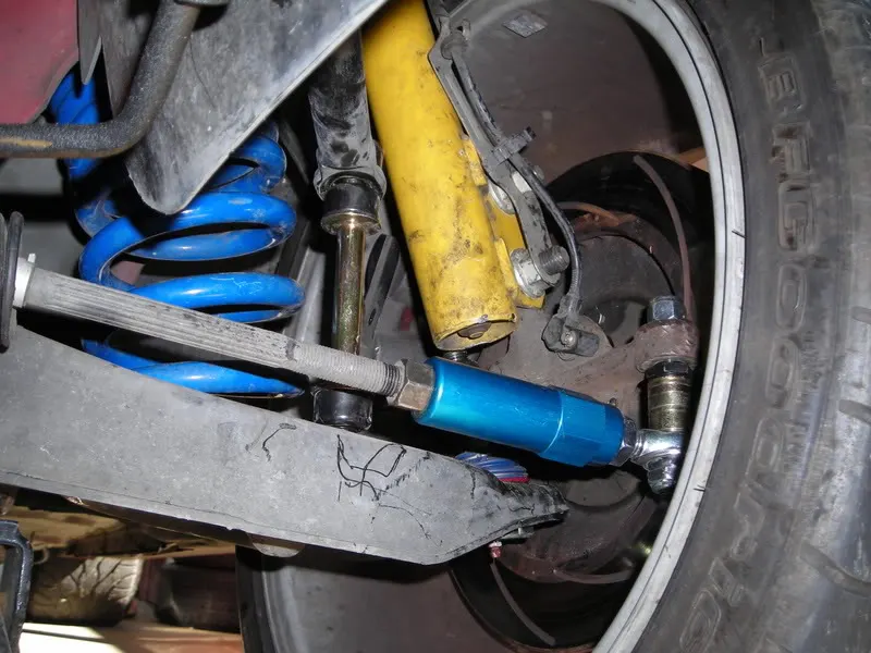

The old & new tie rod end( bumpsteer kit)

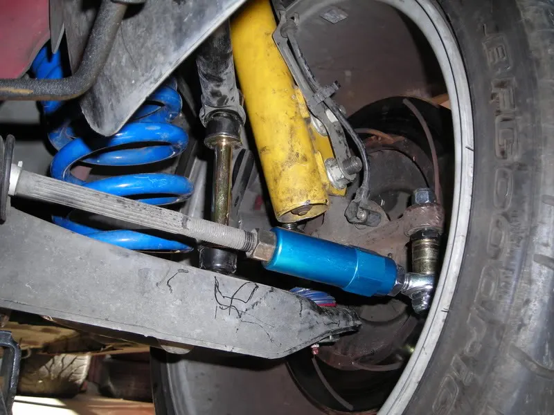

The bumpsteer kit on the car

Now about the handling. Even though the toe & alignment are way off right now, I could still tell a difference in bumpsteer from b4. Right now the steering wheel is off to the right, but on the drive home it felt alot better goin over bumps. You of course could still feel the bumps, but the car didn't want to jerk or pull left or right anymore, or as bad as b4. I could tell the toe was way off though, so the real answer will be after the alignment. Luckily I can drive my Jetta all week till I find a good alignment shop. On another note, I think I still need offset rack bushings, because the tie rods still arent level.
One cool option with the X2 balljoints is the inserts that it comes with. You can leave them out & it will lower your front end another 1/2 inch, but it wont correct the geometry on a lowered vehicle, which is the whole purpose of the X2's. Beleive me I was tempted to leave them out, but I bought the X2's for a reason, so i left them in.
