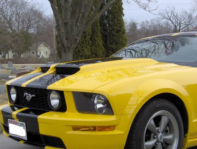

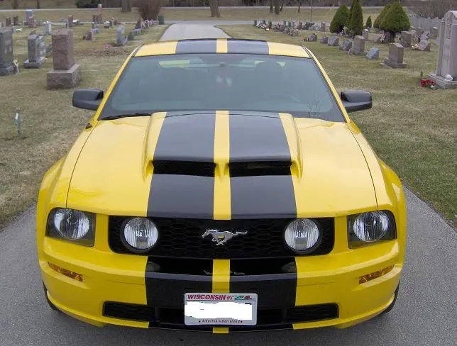

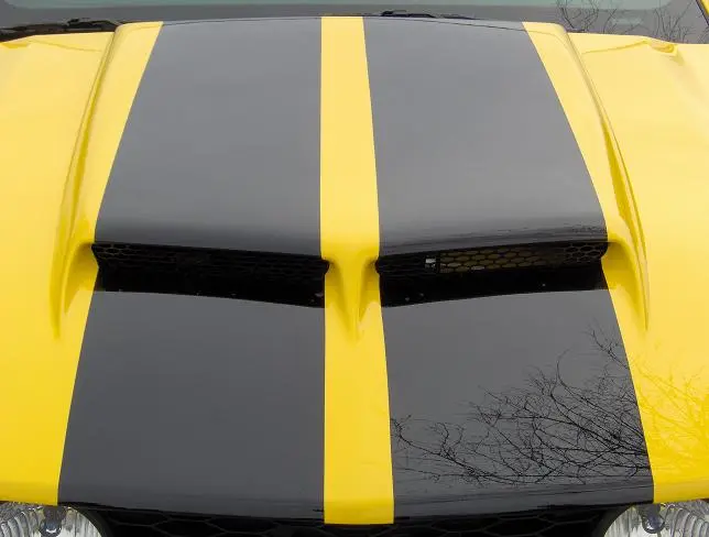

I have the Cervini Ram Air hood painted to match my Screaming Yellow with 2 black stripes going down the middle. My body shop did not paint the fenders/ clearcoat them and the hood matches perfectly. It looks like it came from the factory. They obviously clearcoated the yellow first, then sanded down the area for the stripes, painted the stripes on, and cleared the stripes on the hood.

I think your painter just knows that Ford cuts corners in the paint area for cost savings. What he is worried about is the color of your car being a tad light, due to primer bleed through. Not something you see with the naked eye too much on lighter colored cars.
My black 07 shows bleed through bad, If I were to just have my aftermarket parts shot black and bolted on, the paint on the new pieces would look darker than the oem parts.
My painter is doing the opposite of yours, I gave him my GT scoop and my oem rear spoiler so he could tint the paint. I'll tell you this much, ford is really thinning out their paint. Night and day difference between a exact match black painted part done thoroughly and a oem ford part done on a assembly line.
Your painter just want to make sure your happy with the outcome. He's not trying to force you down a bigger cost. Although in the end it will cost you more. Just have him paint the hood like you asked, the above post shows the naked eye isn't seeing the difference on the yellow anyway.

tinting is done by adding extra paint to the standard formula. you mix up the color, do a spray out to check color, then add the needed colors from the formula. every car is different, and you cannot just mix up the formula and expect it to match perfectly. you want to stay within the formula while tiniting, ie. if you need red, then you use the red in the formula. there are probably 50 different colors a shop can use to make your paint. you only use a few of them usually, and you dont want to add a shade of a color that is not already in the formula.
as far as blending the fenders, you can try to have them butt match the color, and blend later if not perfect. but it is better to do it all at once, as far as cost is concerned. blending the adjacent panels during a paint job is common, and they are not trying to rip you off, just trying to give you a satisfactory result.
I'm not sure HOW you tint paint. I figured with the paint code, you really would NOT HAVE TO tint it much. They said the colors are always off a little from the factory. We've had work done on previous cars from accidents and those shops made them look great.
you tint the color you are spraying, not the car. paint is mixed up in grams, and even one gram more or less of any color can change the outcome of the formula.

Blending is more common than not. Most of the time it won't even be mentioned to you, it's just done. 2007 OEM Ford Black has about 9 legitimate tint variations. The variations should not exist, but runs on black cars are not done all at the same time, or in the same place. You don't just run 50,000 black cars off to cover the worlds needs, you do runs of lets say 50 cars black, 50 red, 50 yellow so on and so forth. Then process starts over and guess what, George who mixed paint on the last run was replace by Mike this time. Yes machines are used to get the mixes within spec, but chances are they don't mix the exact same because both people do the job in their own way.
The product changes too, cost will drive the use of another product and your nuts if you think Ford isn't thinning things out to make the overall cost even cheaper on their part. You think when they thin it's exactly the same every time? Not a chance.
As mentioned, tinting is simply a change in the mix. Subtle but it's a change, body shops and custom painters have to tint to get within spec of oem. As big cat mentioned every car is slightly off. Chances are it will never be noticed, but when you swap out an entire panel, lets say a side skirt or front facia, the seams are right up against each other and sometimes they eye will catch it. This is all that Stanged4life's painter is worried about.
None of this is rocket science, shops these days are beyond capable. Some folks just think they getting one pulled over on them. If thats the case, just let em shoot the piece, clear it and bolt it on. See if you notice anything. If not, your all good. If you see a subtle difference, you'll likely be headed back for a blend or tinted reshoot.
