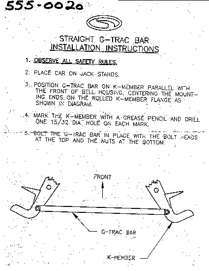

Steeda G-trac bar....doesn't fit??? Anyone have pics of one installed?
I deleted the picture with both from the front. Here is the intructions with the diagram...
BarnStang said:
Bolt the G-Track bar in place with the bolt heads at the top and the nuts at the bottom.
i think I put the bolts in upside down...oh well, it's been on there several years and has noot fallen off...
Haha, yeah i noticed that too.
I have the strut tower brace as well, but for some reason it would not fit with my cobra intake and a 3/8th spacer. I'm gonna take off the spacer (it didn't do anything anyway) and see if it works. If not, i'll have a STB for sale
You've been more than helpful. thanks for taking the time to do this.
All set guys. Got it installed today. Took me an hour to do and got it bolted nice and tight.
I notice it made the car a little more responsive on turn-in. Also, a little less cowl shake
