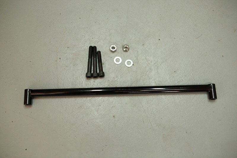

Here are the contents of the box:
I put a short bolt in for reference (the kind that came with the kit). See the two longer ones? I had to source those myself locally...I have the Steeda control arm relocation kit to correct my car's geometry since it is lowered, and if you have that you have to buy your own 100MM long bolts. The ones that come with the kit are 80MM and will work fine if you don't have the control arm relocation kit. It would have been nice if Steeda would supply both lengths of bolts.

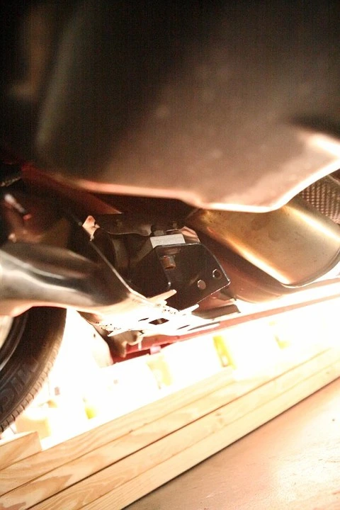

Under car shots in area where it will be bolted. You can see my control arm relocation kit spacers:

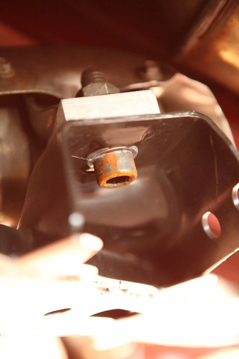

I grabbed a breaker bar and metric wrench to hold the top nut and went to town...
I got the old bolts removed...
