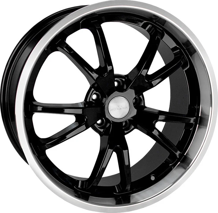

Steeda New Spyder Rims..OPINIONS
94GTLaserRC
Squint as you approach, lest you be blinded by my
I know this is not the 2011 forum but I trust my buds' opinions over here.
Looking at getting these when I get my GT/CS in a couple months. The car will be Silver/Black. Also any performance issues with upgrading to 20" rims?
Thanks
RC
Might a little I'd think due to a little added weight, probably not enough to worry about if it does. You'll just have to mod it to make up for it lol.
I think it's gonna look good.
IDK if theyre going to be heavier..According to Steeda, theyre supposed to be lighter weight rims..i just meant do the SIZE of the 20's affect speed. :shrug: Ive seen plenty of chargers with larger rims and they look hot.
RC
Larger tires will affect your acceleration off the line in a negative way. More rotating mass means your engine has to work harder to overcome the inertia. For an auto, changing out your tire size will also affect your shift points and obviously the speedo / tach. You'll get better highway mileage and worse city mileage.
But the question is, are you actually changing the "height" of the tire (measured from ground to the top of the rubber) or just the size of the rim, and decreasing the size of the tire sidewall so that the height stays the same?
Adam
I don't think those rims will be a whole lot heavier. The tires are going to be a fortune, and the ride quality is going to make your dentist wealthy. Those rims are 20" to clear the brakes Steeda is putting on the car now. Holy Jesus, 15" rotors on the new Steeda stang. That is amazing. the 11' Steeda Stang is also up to 690hp.

How about these:
2005-2010 18X10 FR500 BLACK CHROME WHEELS
They can do Nitto 555's and 18/9 up front with 255s and 18/10 out back with 285s for about $1600 Shipped.

I think they look awesome, and I think the wheel well on the S197s is beg enough to handle a 20 without looking cartoonish.
You're going to get a stiffer ride, assuming the same overall tire height, but that's probably not all bad. I would imagine that the Steedas mounted will weigh less than the stock wheels/tires, so shouldn't be any performance loss from rotating mass. Shorter sidewalls do equal less tire flex, so possibility of some traction loss, but probably not any significant deal there. What is comparison from overall tire height stock versus new? That'll tell you if there's any effective final gear ratio change, and to what extent.
