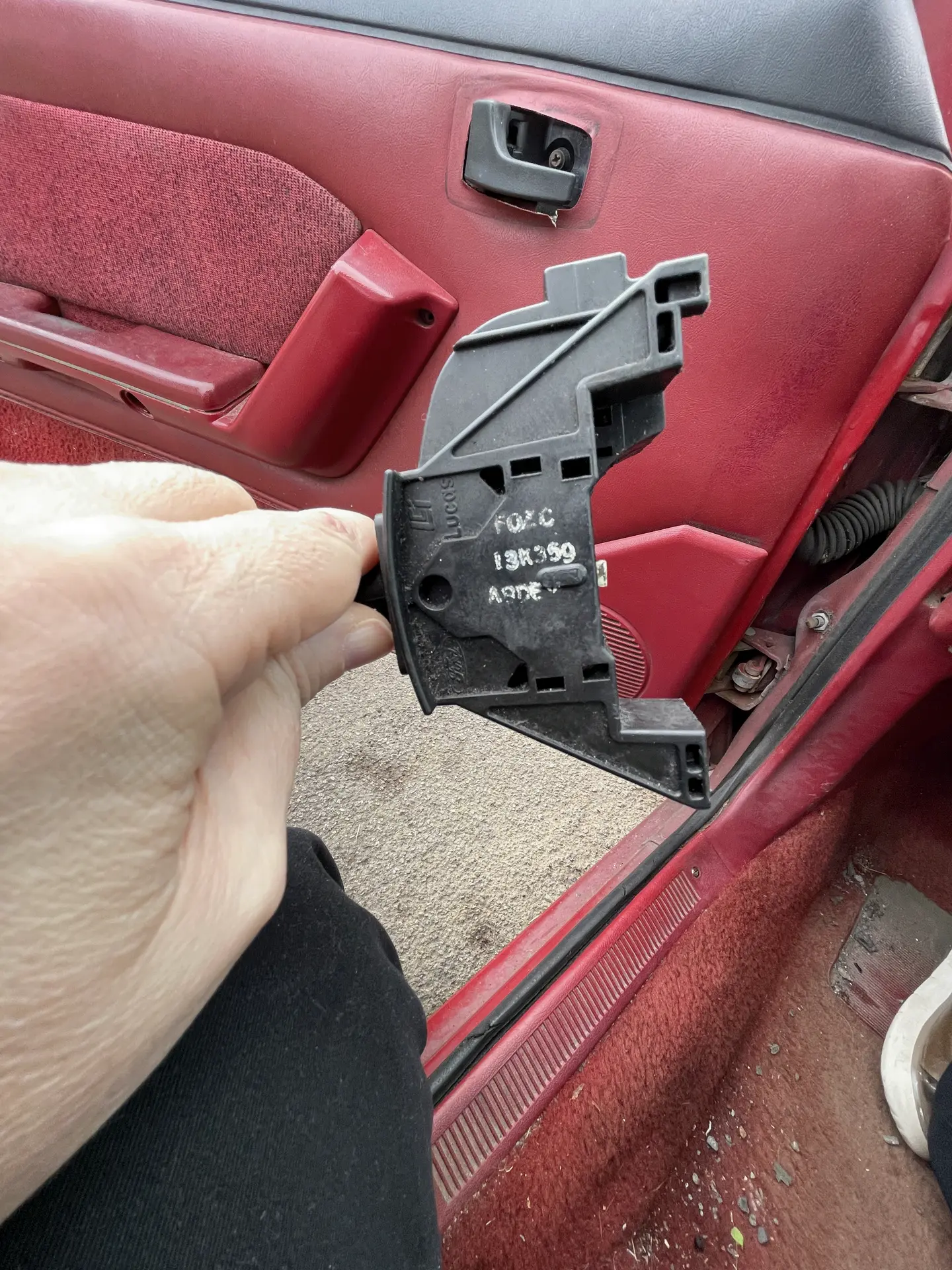

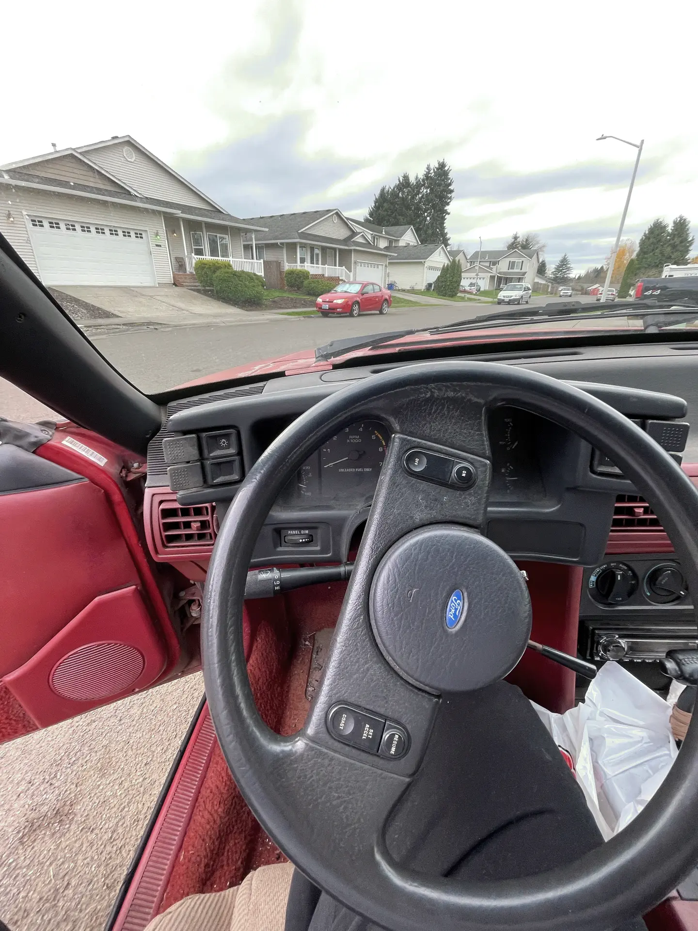

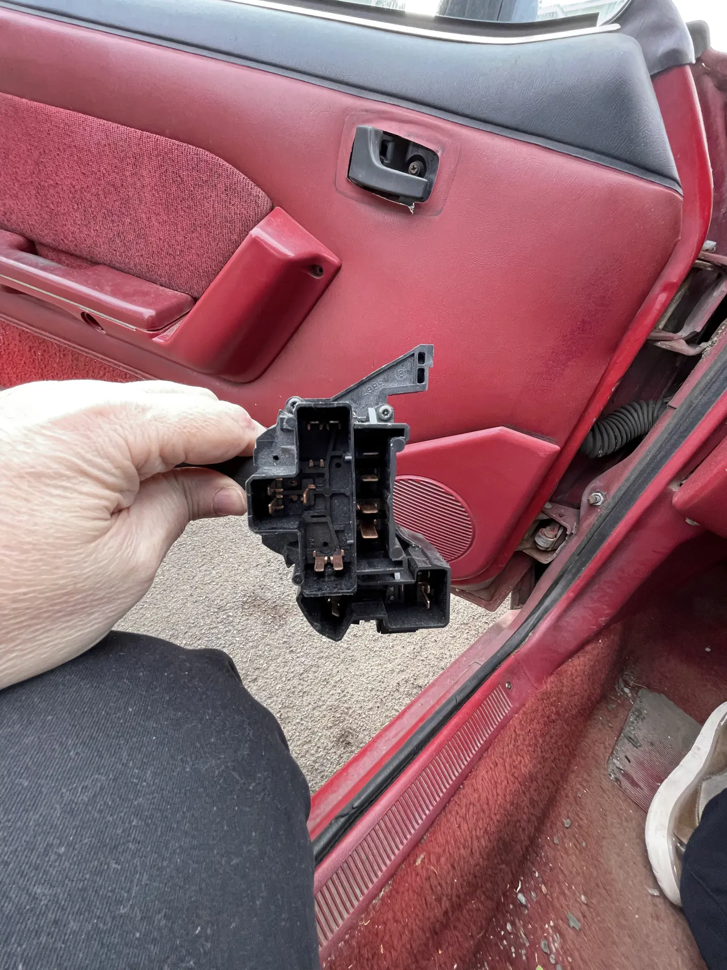

I purchased a used steering column to replace the cracks/loose one I had. Upon installation it appears to be off set to the right substantially. The turn signals and the wipers do not work.Clearly this did not come out of a 87-89 Mustang as the seller claimed. Could it be Cougar, T-Bird, or Ranger? How can I tell? I should of known the deal was too good to be true a fully dressed column for $175 sounded cheap and now I understand why. I did pull the original multifunction switch and that gave me wipers and turn signals, but the column is still off to the right. Anyone with advice?
First 1989. Second, the only pics I could provide are of the column installed and the new multifunction switch. I paid my mechanic $300 to install it. Now Im gong to drop another $300 on installing a correct one.

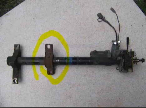

For instance, here's an 87-89 column. The two main brackets that hold it are offset. I don't think the colume will mount with the one closest to the firewall flipped, but if the top bracket is flipped around, it would position the steering wheel towards the right. Some pics would help confirm this, in which all you need to do is drop the column down, flip that top bracket and bolt it back up.
And like i said, the turn signal switch you are using is from a 90-93 mustang. You'd have to repin the electrical connector to get it to work, or you need to go out and buy the correct 87-89 turn signal.

I didn't read all the replies but that steering wheel is from a thunderbird. Not sure if there are differences in the column but I woudl assume so. Try loosening the four bolts that hold the column up and center it to where you want?
