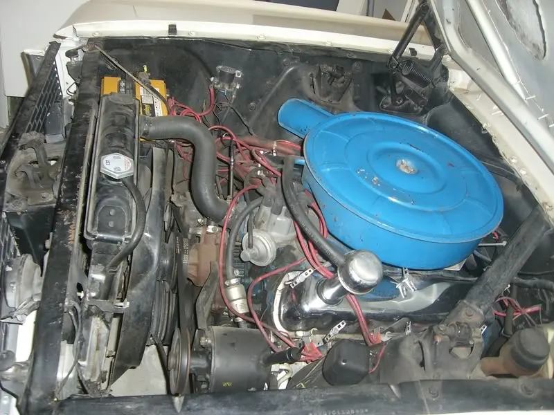

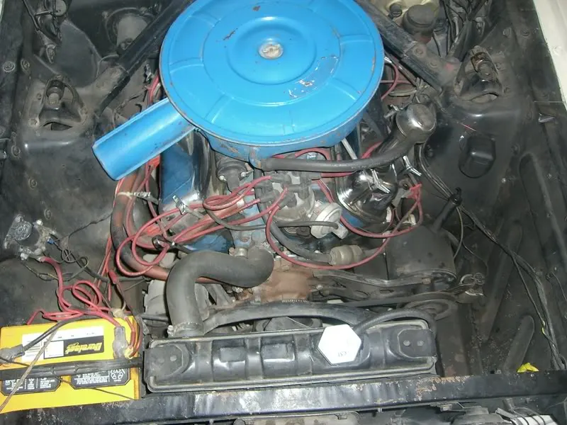

Pics from a while back
Looks like a standard power steering pump to me. I was hoping to get a pic of the power steering components, the power ram and control valve. I would also speculate the control valve is out of whack.
You are probably right about the valve. His pump has the wrong reservoir, but it is a cosmetic difference and should work perfectly. The valves were internally all the same*, the 64-66 center link was unique, in that the ball sleeve was integral, while it was added on to the 67-70. They don't interchange, it's hard to see how he could have the wrong one.
