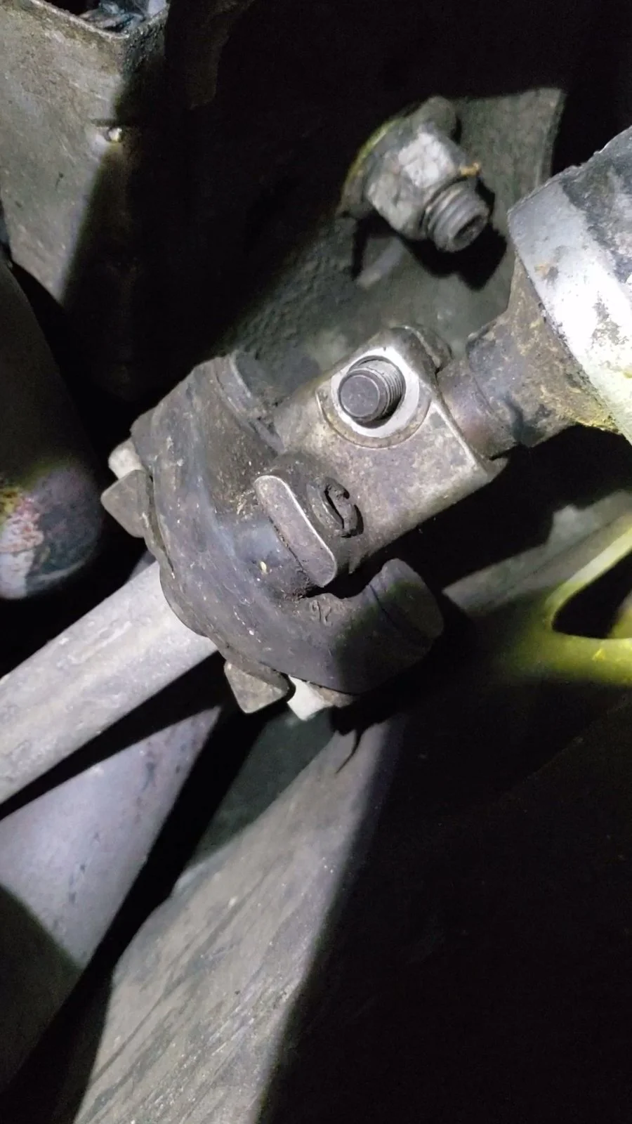

My steering has a lot of play I found the area where the slack is and it looks like it's missing a nut, but the bolt is very tight. Could this be my problem?
That's the one in the engine bay, right? Check joint under the dash as well. Mine loosened up suddenly one day and was almost dangerous to get home, looked under the dash and the bolt was backed out. There was no nut on that one, but I put thread lock on it.
Also, check for play in the rubber "rag joint" under the hood there
It's taking everything in my power to not make a joke about the nut behind the wheel being the real problem:rlaugh::rlaugh: good luck with the fix!
I think you are right. The shaft is threaded on one side only, so the bolt is inserted incorrectly and not "pinching" the pinion.
You can see the shiny area where the bolt head flange previously contacted on this side. Far side is thresded
Thank you. I'm going to try turning it around tomorrow. I just got the car and I cant imagine a scenario where someone would remove the bolt in the first place and not notice that it was reinstalled upside down.
Well it will tighten up until snug when you install it backwards, but the steering will remain very loose. Why you wouldn't immediately check it after driving it and feeling how loose it is is another question...
