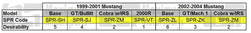

RF-F6SC-3550-AA is the part number for the housing of a rack for a 1996+ Mustang.
The SPR code doesn't match any of the 99-04 racks
My guess is it's probably 96-98 vintage based on housing part number and no SPR match. BUT, it has the splined input shaft setup like the Fox cars and not the triangular SN95 hookup. I wouldn't be surprised if it was a parts store rebuilt rack that used an SN95 housing but rebuilt to Fox spec. Just a guess.

SPR KD is 1996-1997 ALL
SPR NJ is a 1998 V6
EDIT:
SPR NJ is a 1998 V6
