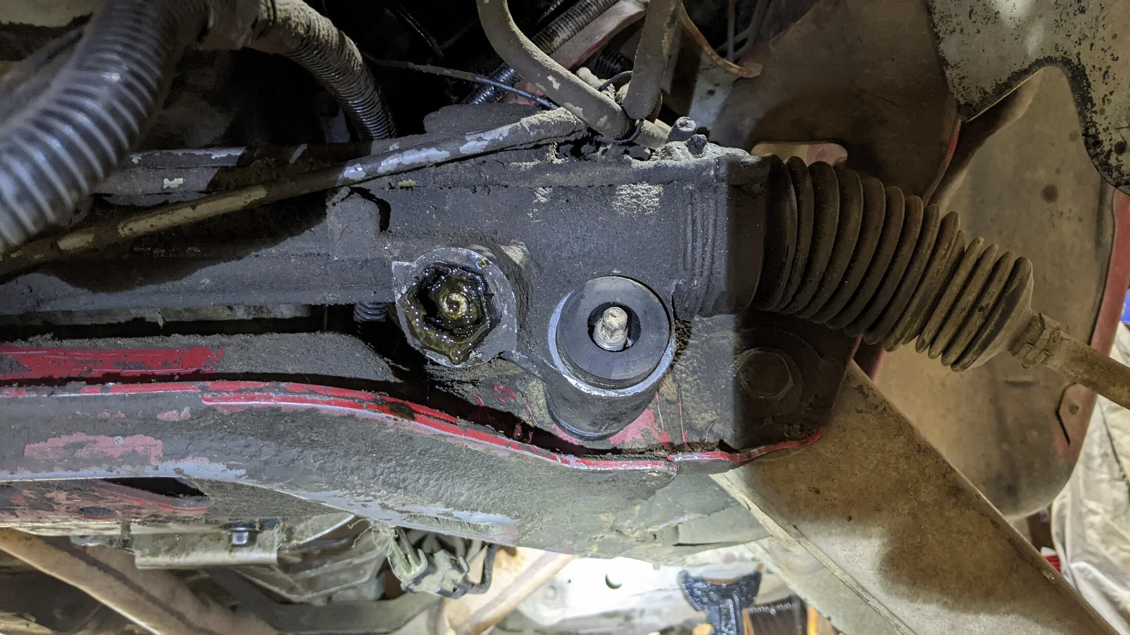

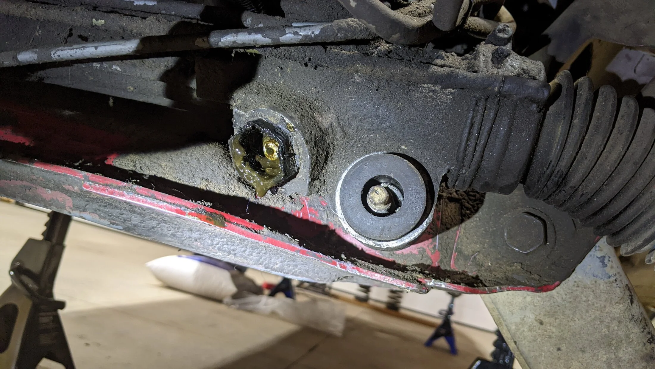

Hey guys long story short I was hitting this plastic piece and it started leaking. (I didn't realize it was plastic at first) it just looks like a big bolt head when it's covered in crap, about 1&1/4" roughly. Driver side.
I decided to just tear it off to see if I can just replace it but I still can't figure it out.
Do I need a new rack? Fill it up with rtv? LOL.

You can replace that part but you'll probably need to take a trip to the junk yard to get a replacement. It may actually be better to just replace the rack. It's a ton of dirt caked up under there. No wonder you couldn't see what you were hitting.
It is threaded. Not really typically removed for any reason.
Gonna be a junkyard only part to find it. Nobody really has a reason to remove it so i doubt you'll find it seperate.
