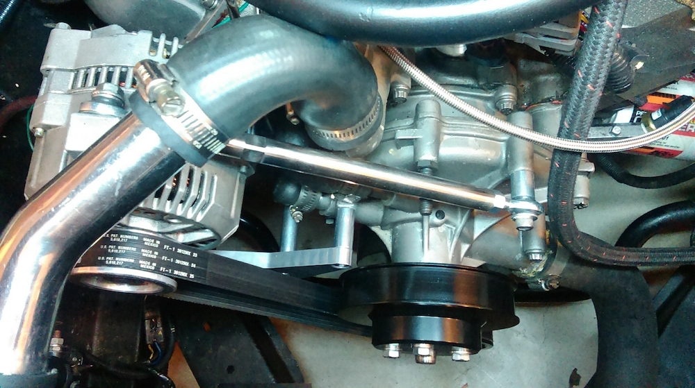

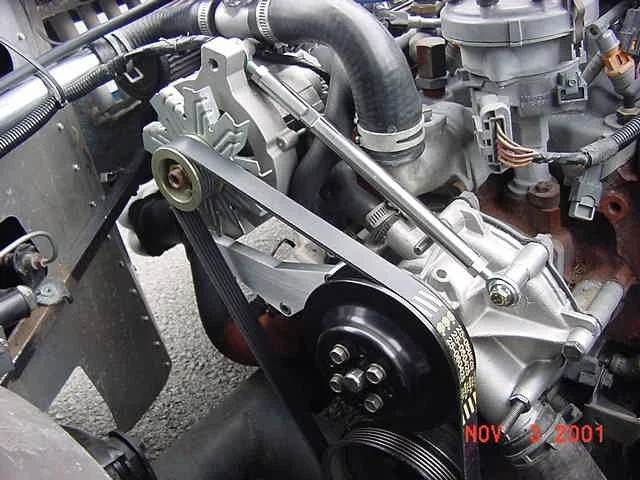

As far as the belt routing is concerned I've ran just the alt, water pump, crank with a short belt and march turn buckle style mount on two or three cars fine. One was a daily driven car for years with no issues. Some say you don't have enough contact on the waterpump pulley but I never had an issue and the daily driven car got ran hard out of frustration in and out of traffic for years. The catch here though, is that I would not recommend this small belt setup to you if you are still using the stock mechanical fan setup that is bolts to the water pump pulley. You could try it I've never done it, I always had an electric fan when running this setup.

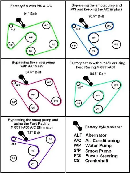

First off yeah my assumption was wrong.. I seen you mention power steering pump and assumed you were doing it the half assed way with leaving the power steering rack in. My fault but to answer your ONLY question which I ALREADY did. You can run a shorter belt as long as your not running a mechanical fan. Or get yourself a bobo idler pulley if your not comfortable with the shorter belt.

If you have ac, just use the shorter belt per the last post. I rigged up a junkyard pulley bracket on my 82 when I pulled the ps because I did not have ac. Later I went to a std rotation waterpump. This harder than you would think.
