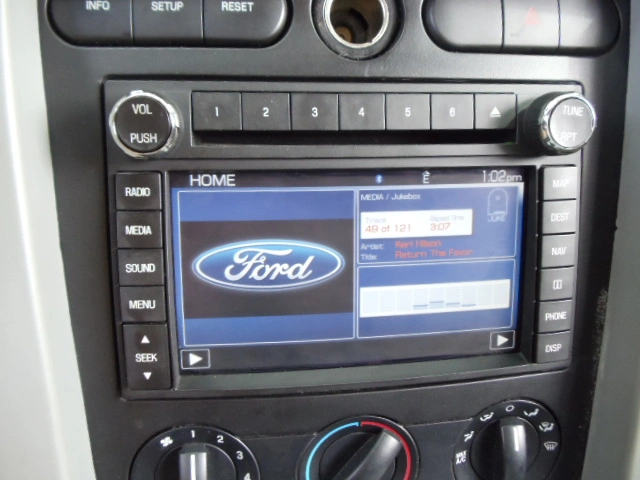

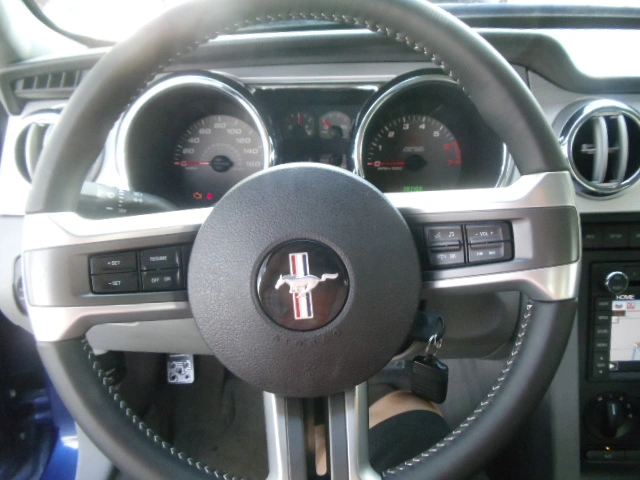

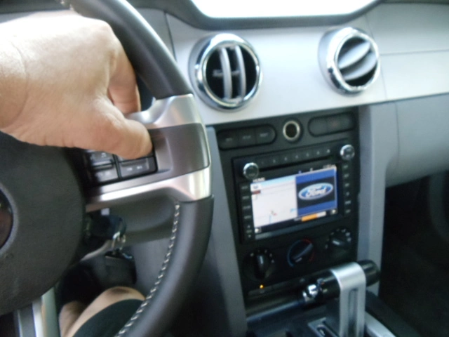

You can use a 2012 steering wheel in a 2005-09 and also the clock spring but you must have the connectors for the new style clock spring. The older o5-09 connectors are different and will not fit the new clockspring. I have both 2011 steering wheel and 2011 head unit, with full function sync. and steering wheel controls on my 05. There is a lot of technical hooking up to do. It took me about six months of research and programing to break through. If you look at the 3rd pic you will see an orange bar on the bottom of the nav unit screen that is the volume being turned up by the steerning wheel switch in the second picture. By the way all swithches work, I also have the sync hooked up for voice controls. This is a very nice mod but it's a bit pricey. Look at the pictures.
