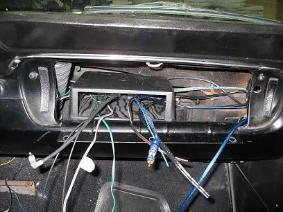

I just went through this thought process. I didn't want to cut the dash so I am putting it in the glove box and running the aux input down to the console for my ipod. That way when the glove box is closed I still have the original look. With remotes you don't need to have it out in the open anymore (assuming it is a good remote). I was thinking of hiding it in the trunk since it is mp3 but I would have to run the radio antenna a long way if I wanted radio. I got a basic head unit with good sound as it will be hidden anyway.
It is still a work in progress but I got the mounting all in and the wiring done I just need to connect it up and slip it in along with the modified glove box. I created a plywood board to go under the case and screwed to the existing two holes that were for the glove box. I was going to attach the back to the heater box if needed but the front provides enough support so the back just rests on the top of the box.
