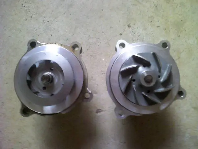

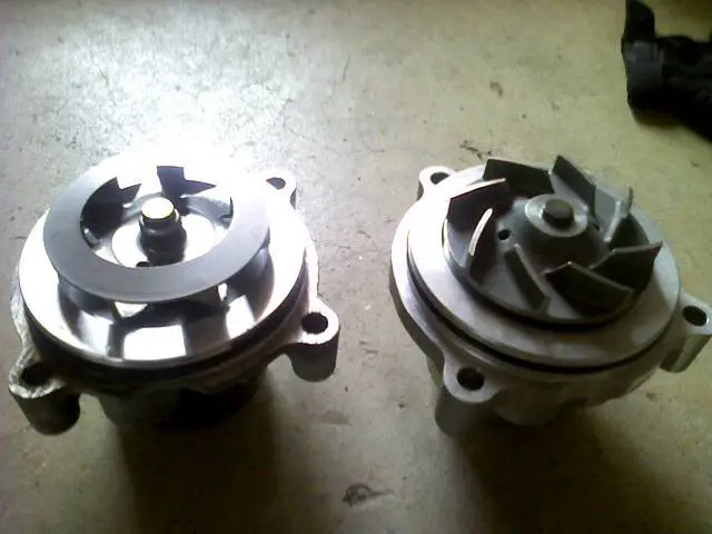

I just installed the Stewart EMP Performance water pump from Steeda today on gt. $149 for the pump. Pics below. New pump is on the right. The blades are about twice the length than stock.

looks nice. with those long blades it will flow alot more water then stock looks like a good upgrade for anyone with FI

From what i read they only take 2-3hp to run compared to 4-6hp for the stock so besides the extra flow benefit it will net you a hp or 2.

Can you say "cavitation"? There's a reason Ford designed the pumps the way the did. Bigger isn't always better, boyz.

How is the bigger blades (more pressure points for the coolant/water) going to net more horsepower with more drag?
Cavitation is the 'formation of vapour bubbles within a liquid at low-pressure regions that occur in places where the liquid has been accelerated to high velocities, as in the operation of centrifugal pumps, water turbines, and marine propellers. Cavitation is undesirable because it produces extensive erosion of the rotating blades, additional noise from the resultant knocking and vibrations, and a significant reduction of efficiency because it distorts the flow pattern. The cavities form when the pressure of the liquid has been reduced to its vapour pressure; they expand as the pressure is further reduced along with the flow and suddenly collapse when they reach regions of higher pressure. The sudden growth and collapse of these vapour cavities cause the extreme pressures that pit the metal surfaces exposed to the cavitating liquid.'

Very good! You get a gold star for the day! Bonus points on the "more drag = less horsepower" comment.
For the life of me, I can't see how this could be true.

according to steeda the stock water pump starts to cavitate around 4500rpm

Almost every serious road race mustang is running a high flow water pump of some sorts, most of which are far more extreme than this unit. I doubt this pump will have much if any cavitation issues. This probably isn't a good mod for someone wanting extra hp but if you want extra water flow it's a no brainer.
