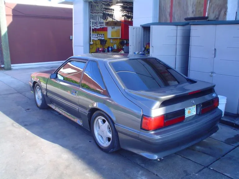

thats a pic of my stang! its a decent stang...
