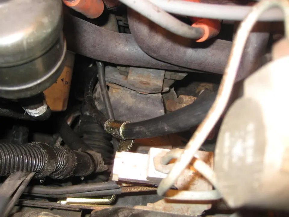

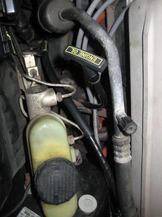

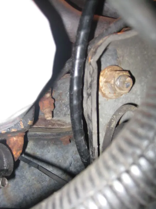

heres a pic hope it loads
cable001
cable002
cable004
No, it doesn't look right. It should be loose in there, not tight against everything in there. It looks like the cable is too short. It shouldn't be snug against the front of the motor mount like that. I lost my entire hard drive when I reloaded my computer, so I don't have any pics right now.

That routing doesn't look real desirable IMHO. You want a nice big loop without any kinks or places where the housing catches/chafes (since it moves a little when the cable is tensioned and released).
