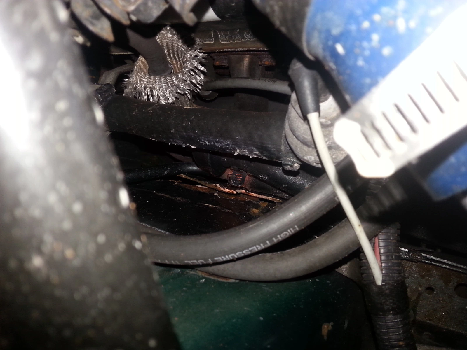

Wow thanks for the clamp tip! I just checked all the new clamps and man they were loose. They were very tight when I installed them. I used a socket and it tightened it very well. Also quick question I don't know if this is a good pic but what's going on here it looks like something is broken possibly by the motor mounts check out the pic and let me know what guys think.

That's a really crappy pic but it looks like a piece of the engine bay is broken off not sure what it is its a piece of metal or fiberglass or something its painted body color and is about 5 inches long 4 inches high. The car drives fine though so I hope its not a big deal. Ill fix it when the engine is pulled for the rebuild. Also how hard is it to do a wire tuck in the engine bay do you have to modify the wires at all is there any cutting and splicing? And what about filling all the un needed holes with bondo or something? I don't have a welder. I can weld but I'm not to good at it. How much can I get cheap lincoln welder for? I might n e able to do it at my job as we have that little welder I just need wire for it. Also can I just cover the areas with sheet metal? I should prob start another thread but what the he ll I like you guys lol.

I would need more pics but it looks like something got too hot in the area.
