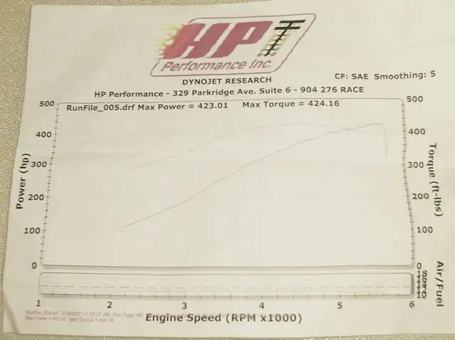

NotA4.6, just to clarify...are you saying you put a used S trim on a 5.0 with stock heads, stock cam, and stock intake and made 425 hp/tq to the wheels? And you do this without any tuning at all except for injectors/MAF/fuel pump upgrade? And the car ran perfectly fine?
If you reread my post you'll see that I did say I got a tune at the very end of the post. I wouldn't even consider driving an SN5.0 with a blower on it and no tune. But the entire bill was right around 3 grand turn key. You won't make this kind of power, be streetable and reliable with H/C/I at this price.
NotA4.6, I did read your entire post. I asked that question because it seemed to me like you were saying the tune was swapping the injectors, the MAF, and the pump. Fair enough, my mistake. I agree that you won't make that kind of power on a 302 with HCI. However I have to say I'm a bit skeptical that you made that kind of power with an S-Trim and stock HCI to the wheels. Taking into consideration parasitic losses, drivetrain losses, and the integrity of a stock short block and components I have some doubts. No offense intended and I will say outright that it is possible that I'm wrong and you actually are making that power. But if we can keep this friendly then I have to ask if you have the dyno sheet to show it? Also, were you using an intercooler with it? Or maybe meth injection? Because you'd need approx 15 lbs of boost to make that power and those pistons probably, probably, can't handle that kind of boost without meth/aftercooler...
it made 13 psi on the dyno with a 3.33" blower pulley, power pipe and stock vortech crank pulley for our cars. On the street it would go up to 15 psi so there's no telling how much more power it made at that point. Really makes me want to get another Vortech for my current car because the combo worked out well.
It's all good man! Yes it was 13 psi and the guy tuning the car is one of the best in the business. Car was rock solid reliable even in the hottest and humid mid Florida heat.
Here's the dyno sheet:

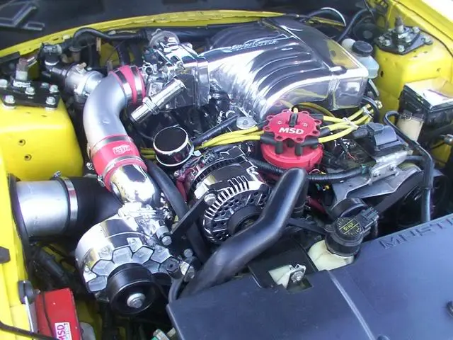

Here's a shot of the combo:

Sorry to be a post whore but wanted to break down the costs of my blown setup for the OP so he could weigh the options:
$2000.00 V1 S trim kit with AFM Power Pipe and Vortech mini race bypass valve (I polished the blower myself as it was unpolished and that's what I do for a living)
$105.00 255 LPH Walbro FP
$250.00 42 LB injectors
$80.00 80mm Pro-M MAF
$135.00 Used SCT 4 bank chip
$200.00 4 runs on the dyno/tune
$100.00 Misc nuts/bolts/brass fittings/tap&punch/gaskets/little crap that ruins your day when you do any project!
$125.00 Aeromotive adjustable fuel pressure regulator (probably wasn't necessary, but I wasn't taking any chances)
Total for the finished project was: $2995.00
Keep in mind that even with a H/C/I combo you'll still need things like injectors, maf, fuel pump and a tune if you want it to run right in these cars. And all these items' cost doesn't change much when you're buying for a SC'd car or a N/A car.
