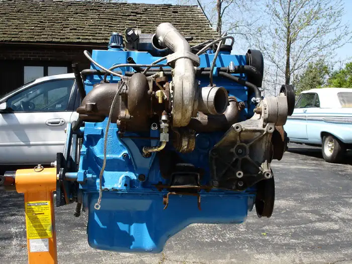

hello i wanted to know if any one is useing the stinger header, and fi you can post pictures as to how the oil drain line was installed me and my buddy who iam building the car with cant figure out how it should be installed.
I have one on my car, It pretty much just goes straight from the flange on the turbo, back a little, and straight into the block. Here is a pic of how mine is on the car. You can see it if you look under the turbo. Its the best pic i have the line.

thanks for the pic. me and y buddy that i own the car with are also useing his header not the stock one. damit lol. i new where both ends go iam not that dumb.
we where able to get it to go from the turbo to the inlet by snaking it thru the header pipes but the problem was it didnt seem right and the t 45's that he sends with it when tighten wouldnt point the right way.
