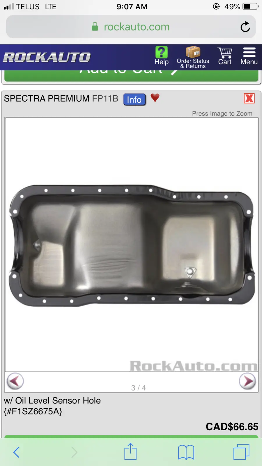

The stock 5.0ho oil pan as shows, has two drops so that the pan can clear the subframe. Because oil sits in these two drops when resting, obviously you’d need two drain bolts, but when checking oil level, couldn’t that give you a screwed up level? If some of that oil is on the other drop, and the dipstick reads from pickup side, how the hell are you gonna get an accurate reading?
Never had a car with two drain bolts, so first oil change was pretty amusing lol. Never had low oil pressure or the low level light come on, just curious
I thought of that, but following the dipstick tube, it leads to the sump side, makes me think it’ll check level there because it would hold more than the opposing side. I think at any given time, as long as your oil level is in the “okay” zone it should be fine

If there's enough oil in the pan, the level is high enough to be over the hump and equalize.
