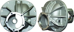

You can probably get away with the stock 8" Housing if you change the carrier:
This is a unit from Currie Enterprises.
http://www.currieenterprises.com/cestore/all8inford.aspx
I imagine a 9" would cost quite a bit more than a beefed up 8".
