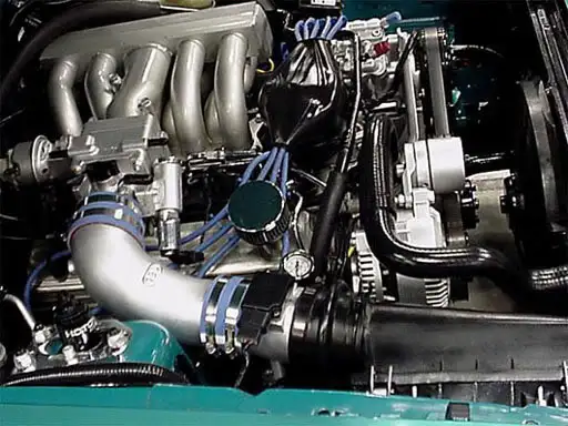

I've decided that I want to get my air filter out of the hot engine bay.
I want to be able to still use use my C&L CAI and Meter instead of buying a whole new set up.
The stock air box on here is sold. There is one on ebay, link below.
http://i131.photobucket.com/albums/p286/93gtmustang/d1ea_1.jpg
http://cgi.ebay.com/ebaymotors/1987...ryZ43946QQssPageNameZWDVWQQrdZ1QQcmdZViewItem
If you look at the picture from C&L it looks like there's a special coupler that goes between the MAF and the air box. Where would I get one if needed?
My other option was a Kenne Bell Ram Air Intake. I wouldn't use this if my car was a daily driver, but it is used for strip more than street.
http://www.kennebell.net/accessories/RamAir_86-93mustang/RamAir_86-93mustang.htm
Or maybe I could buy an elbow that would go into the fender wall and a fender wall filter.
Any suggestions would be greatly appreciated!!!!

I run a pro-m bullet meter with the C&L pipe and stock box...tuner actually commented on how flat my A.F was across the board and how easy it was to get the desired ratio as a result.

vristang said:
If the CAI puts a bend just before the C&L, then you are still likely to have issues.
The stock airbox is the best way to run a C&L meter. This is the only application which they were meant to be used in.
Keep in mind that the stock airbox is a CAI... and will not be a restriction.
If you are going to run a C&L MAF, then the stock airbox is the best way to do it...

Answer to your first question is that coupler in between the mass air meter and stock air box is a ford OEM part, if you need the part number I will be home this weekend and I can get it for you (PM me if you do).
And I had the kenne bell ram air intake on my stang when it was SD and I did not like (the previous owner had installed it). I saw a couple dyno sheets where they lose hp from installing the KB ram air over the stock box with K&N. I did not like the look of it installed.

Take a serious look at AFM power pipes and PMAS meters if you are running after
market heads and intake. They relocate the filter and the meter to the fenderwell. Cleans up the engine bay nicely and definitely adds more upper end power if you own a modified 5.0 (heads, cam , intake) I am not a fan of the stock airbox unless you have a stock head and intake motor.
Even with a wimpy bbk fenderwll cold air intake my 93 cobra (stock) picked up around 5 rwhp in the upper rpm. I would post up the dyno sheet but that was back in 98 and no longer have the file

I would recommend him to the AFM powerpipes as well, but none of the power pipes with work with the C & L 76mm MAF. You can call anderson to verify, but already have, I wanted to go with a power pipe as well but the C & L is only designed to work with the stock air box.

yeah I know. That is why I mentioned the PMAS meter. From a self EEC tuning standpoint I do not like the C&L stuff. I have seen way to many problems with their meters

I bought the car with the C&L already in it. I bought a new Ford Racing GT-40 Crate Engine with B-303 cam and I bought a C&L sampling tube for 40.00 when I changed to 24lb. injectors instead of paying 280.00 for a pro-m to see if it would work ok. I figured $40.00 was worth a try. It works ok actually. I just don't like the filter in the engine bay sucking hot air.
I just bought a stock air box with the coupler on e-bay for $35.00 shipped.
What type and size fasteners do I need to mount it to the fender wall?
What number K&N Filter do I need. Is #33-2015 the right one?

I am sure that setup will work fine but one day when your budget allows, you need to try out the AFM PP and PMAS 80mm combo. It will maximize your power

I installed the factory air box with a K&N panel filter. Low end and light throttle driveability is a big improvement. Thanks for all the help!!!!!

I called C&L today about my application. They said, if you have a electric fan, a conical filter will work fine with their MAF. An electric fan, due to the size and air it puts out, will not effect the read on MAF.
Yea, what else would you expect from C&L. Clueless tech, and BS products.
Electric fans *do* result in fan wash. The MKVIII fans pulls more CFM than the stock fan, and you have less of a shroud!
For an electric fan to work on a 5.0, it must pull a lot of air! Plus, you're pulling that MAX amount even at idle and with a small shroud. So, at idle with a proper electric fan (that won't over heat your Stang), the fan's wash will be worse!
Go with the stock air box, or the BBK CAI kit.
