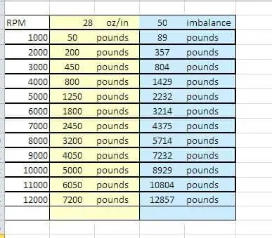

The reason or part of the reason that my stock block 331 is still running 470whp after 9 years.
Your stock balanced 302 is the same force on the block at 6K then mine at 8K. Yup it sees 8,300rpm at the track, 7,600rpm on the street.

For what it's worth, my 500hp tire 347 was 50oz imbalance.
Kurt
