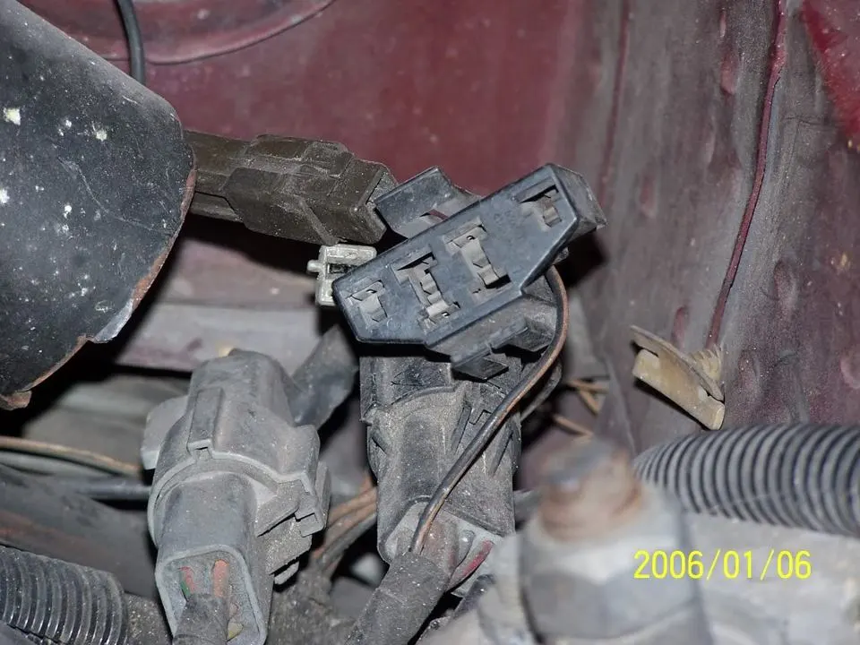

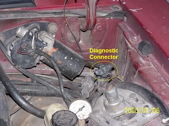

Clue – listen for the fuel pump to prime when you first turn the ignition switch on.
It should run for 5-20 seconds and shut off. To trick the fuel pump into running,
find the ECC test connector and jump the connector in the upper RH corner to
ground.

Before I started all this I did the jumper test with the diagnostic connector to see if I could get anything from the pump and nada, I've now repaired the baffle, assembled and installed the new pump, and still nada. My fuses are all good so now I'm wondering about these "fuse links" mentioned earlier, can you go into more detail and how do I locate them?

Quick update, the pump relay and connector had become one...in the biblical sense. The whole mess shorted and fused together, bought a new relay and connector, cut and spliced the whole mess and cleaned it up...the new pump is humming away now. Lesson learned, check the little things first.
