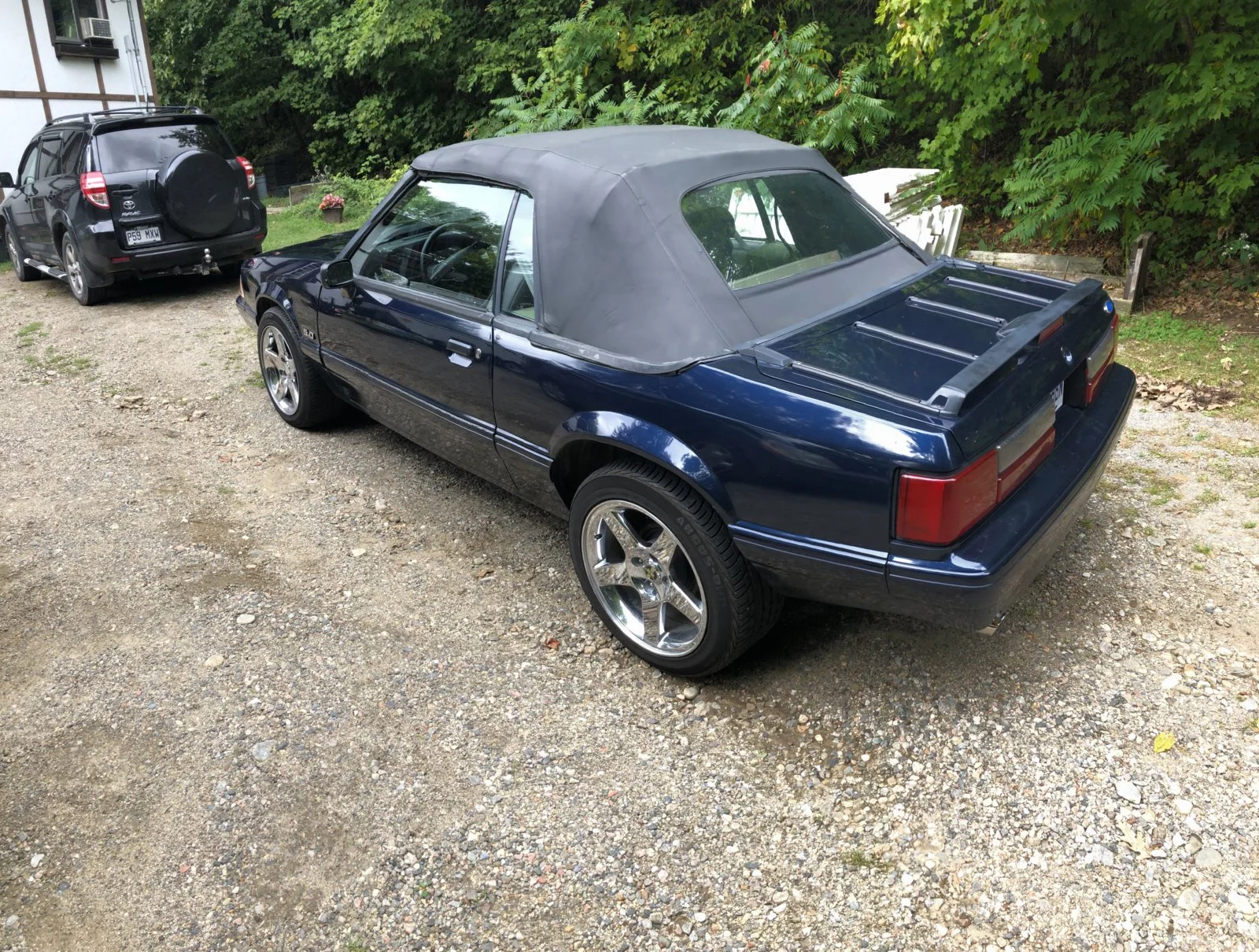

Hi everyone,
This is my first ever post. I have a 1991 Mustang 5.0 LX. I'm looking to increase the air flow to the engine. First of all, I would like to change the original intake for a cold air intake. I will also change the original throttle body for a 70mm. That said, should I upgrade the original 55mm MAF? I think that keeping the original would create a restriction... Am I right?
