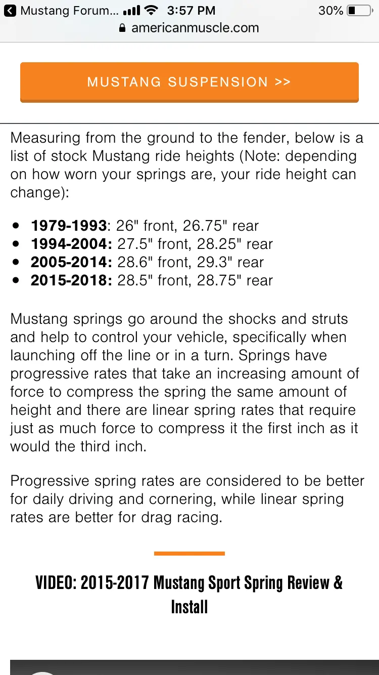

From floor to top of fender, what is stock ride height spec? I’m at 28” in the front and 27” in rear right now, and I’ve got to get rid of the sag. As far as I know, the car has stock, original springs.

I guess I did say “get rid of the sag” but I really want the front to come down. The 27” looks about right for stock. The 28” looks too high, which is why I’m wondering if there was a Ford spec for this measurement.
according to CHEK-CHART alignment specs 7-5/8 " from frame rail to floor just behind front wheel.And 6-11/16" rail to floor just in front of rear wheel
Thanks Steve. I’m going to check those measurements and see what I come up with. I found this on American Muscle also, but these numbers are lower than what I would’ve expected for stock.
