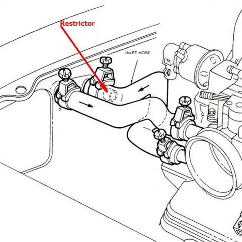

There is a restrictor in one of the lines for the heater core from the factory. I should be on the inlet side if it still exists.

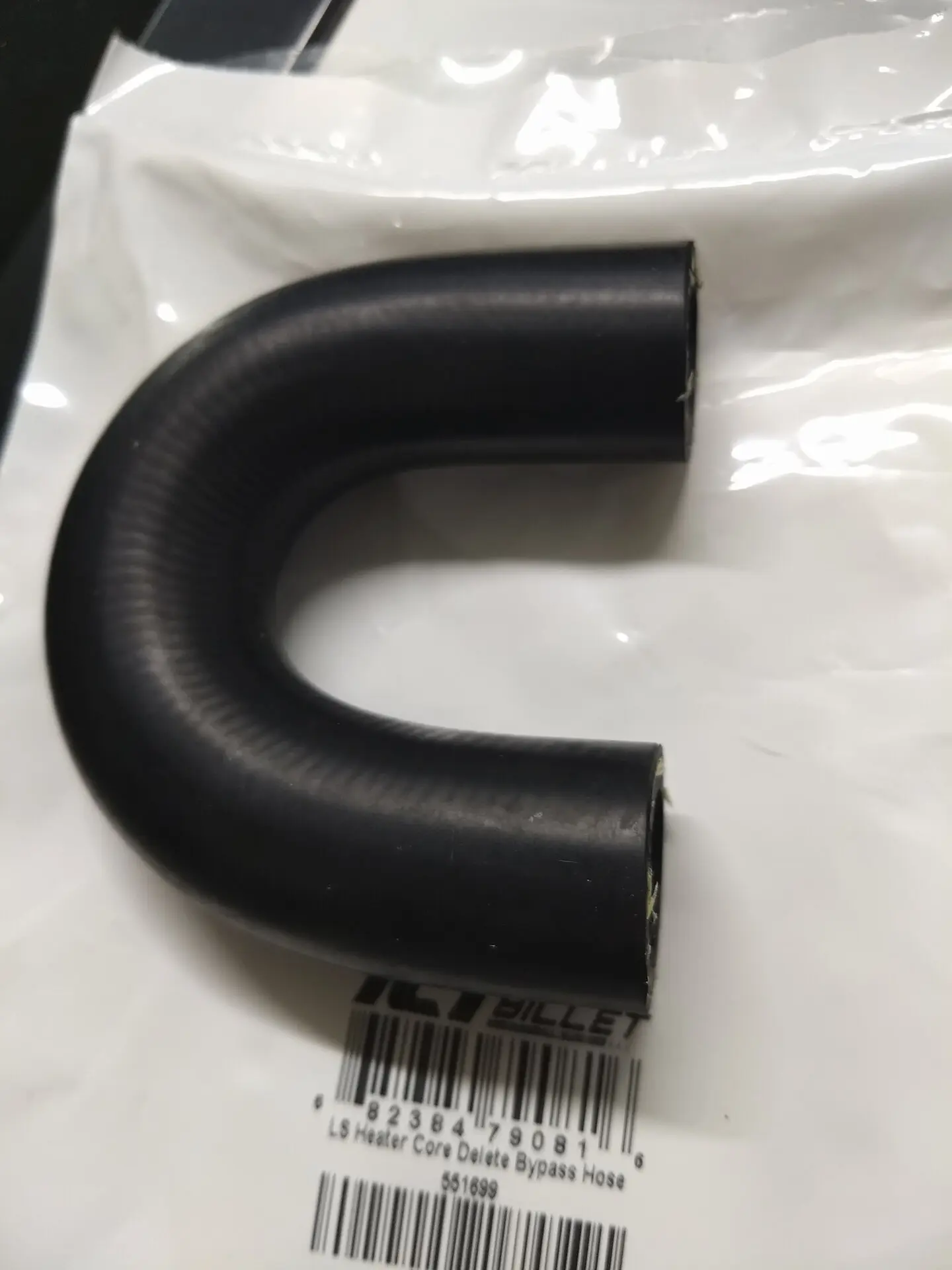

No restrictor from the factory on my '88. Heater core gave out 2 years ago, so bypassed it with a hose. No heat needed in S. FL.

...and note that the restrictor is not part of the hose or rather did not come as part of the hose.
...and also note that the OEM restrictor was metal and not plastic and was, for observation purposes, [pressed] into the hose meaning that the fit was very tight. It would have felt just like a hard spot in the OEM inlet hose about a 1/2 inch to 3/4 inch long.
This image shows the original location:
It's also a better representation of the size and shape of the OEM piece.
