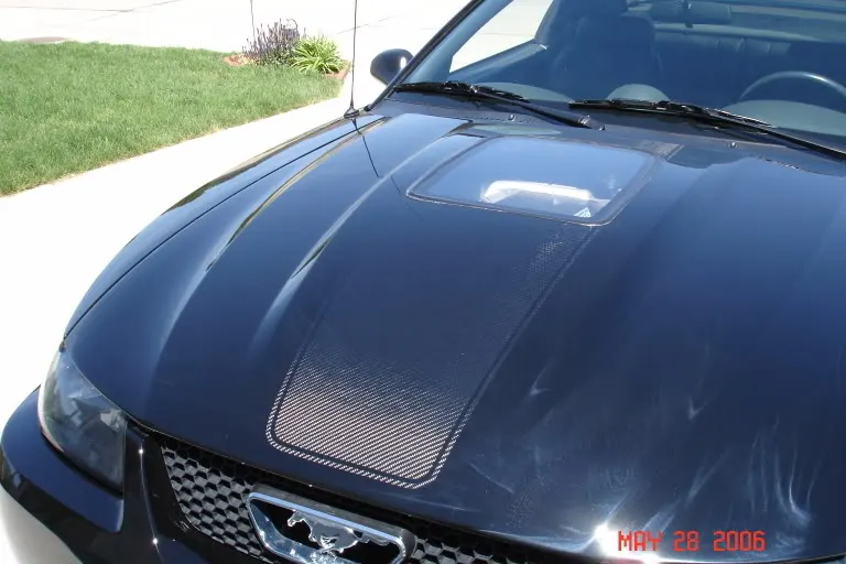

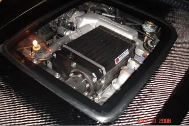

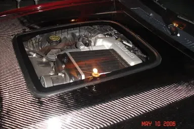

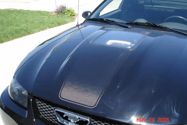

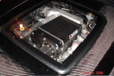

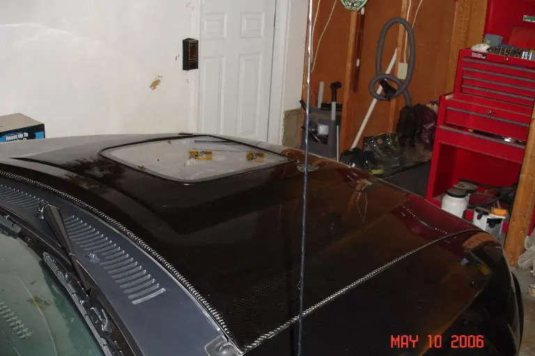

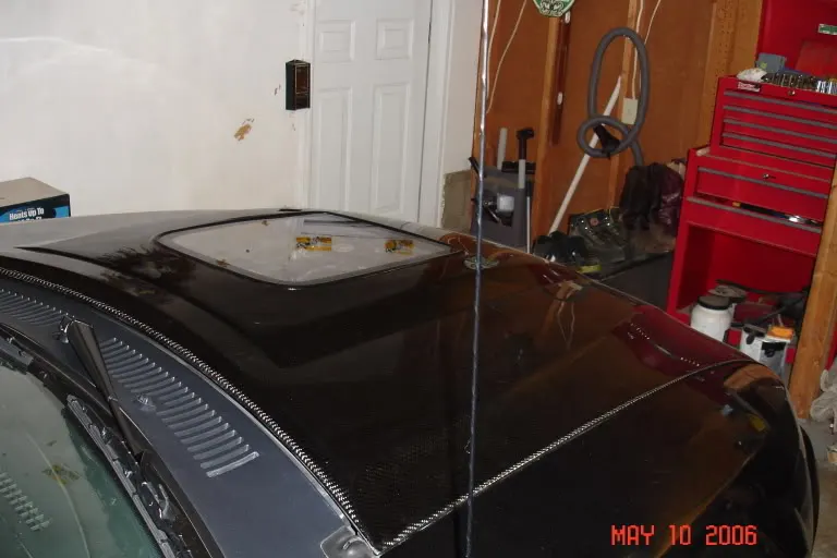

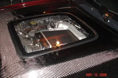

Ponyboy, that hood is pretty badass. Is that a Mach1 hood, or custom made? Does the KB stick up through it? Got pics of it closed? ;)
geoffsgt said:
Yeah, I'm more than willing to adjust my... driving habits for the sake of my car. I have never even considered raising the rev limiter on my car.
why yes i do, time to whore:p
yeah its a carbon fiber mach 1 hood with a plexi glass window:D
heres some pics of it when the hood was still unpainted
here it is painted
