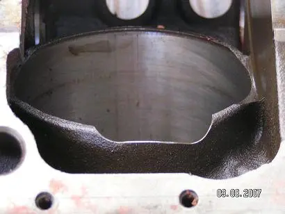

Maybe this pic can help you out some. I didn't do this myself, but it's of my 347 motor.
