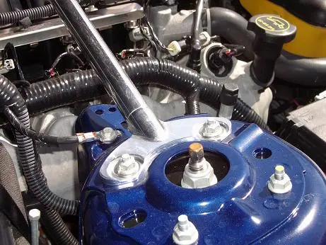

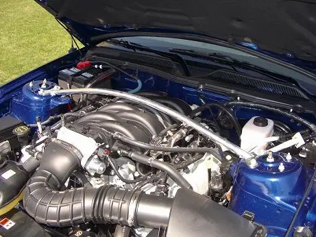

I ended up getting Strange Development's strut tower bar. Quick install as well. The bar has got a constant cross section which I know has great benefits towards rigidity. If you plan on throwing your car around corners, its important to have a bar. Transfering loads across the frame really help a lot in the long time life of your car. I personally didnt like steeda's because I have used theirs before on a SVT Focus and wasnt impressed. I think you pay more for a name than some good ol fashion engineering. I picked a smaller company because they can't hide behind a big label. I found the same has worked well in car audio too.

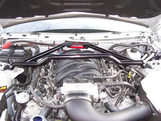

I just installed the Edelbrock Strut Tower Brace, have to say it went in better then I thought took about an hour. It's a three-point design the brace from the 2 struts and then back to the firewall with a bracket from the firewall to the cowl. I couldn't push it hard going to work keep getting mom and pa going to town and the corners were a slow zone..lol coming home I had a chance a few times to let her go and really it felt tighter but that could have been me just thinking of all the bolts and how tight they are..lol I will post some pictures tomorrow of the brace and the bracket.
05canuck, how much clearance is there between the top of the plenum and the bottom of the brace? It looks like it is pretty close.

Eh I dont know if I like those agressive bends in those pipes. I can see them being stress raisors and cracking if you keep putting heavy cornering into them. Whenever you create a new NVH load path for forces to travel you want MINIMAL stress raisers. I'll post some pics of the one that I bought. The link was http://www.strangedevelopment.com/ they are a sponser to this site I believe.

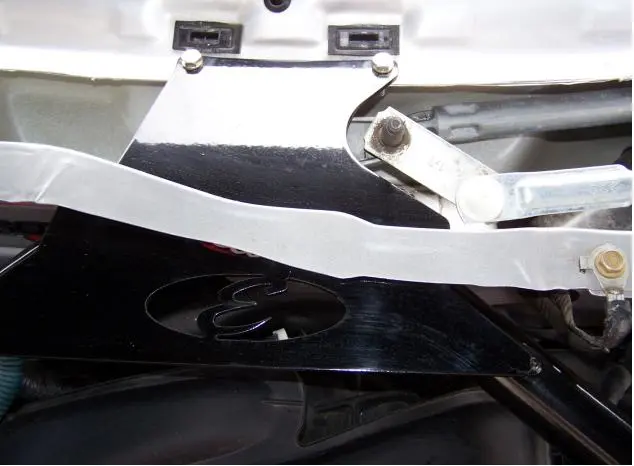

It goes to the firewall is bolted then has a bracket that goes to the cowl and is bolted. This pic shows the braket and how it is installed. Structural point I don't know about but I work for Ford and will ask one of the tech teachers today.

Awesome timing RJC as I had to show the guy at work this thread to show what my brace looked like as I have mine all together and you can't see it. As far as the cowl not being a structural point in the 05 it is. both for front crash and roll over. If the brace was not there is would be more show then go but as the brace ties everything together he said it would offer more overall chassis stiffness. he did comment on the way both bars only connect with a half rings and not a full and that the way mine is bolted and not a solid bar going across is not the best way to go. The bends to a straight bar make very little diffence as long as the bends and welds are good. I did ask him about pullies as well but thats for a diifferent thread..lol. btw hes been teaching Ford mechs for 14 yrs he sounds like he knows what hes talking about hope this helps..
nice bar RJC I like that is clean and chromed
I agree the bolts allow movement between the bar and the mounting plate, effectively making the bar have no effect against the forces that would cause the front structure to flex.
A solid bar (no bolts) would be better. Look at the under hood photos of the GT-500. It has a strut brace that looks similar to the Strange Delelopmment's bar.
