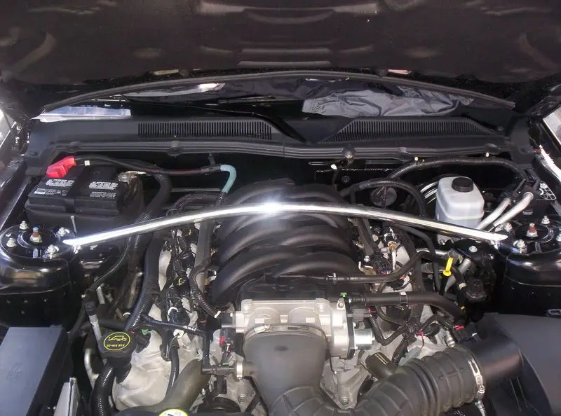

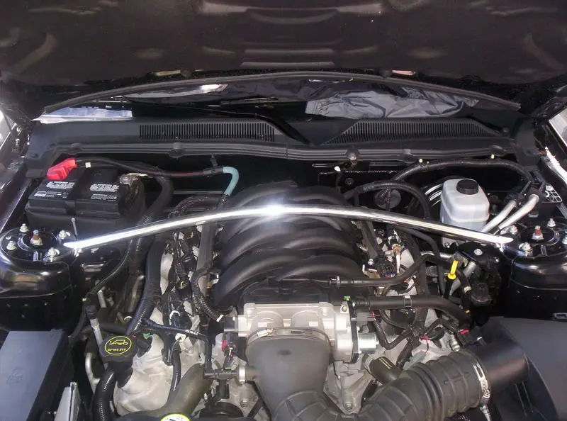

i have the strange development bar, and it is about 1.6 lbs, IIRC. very lightweight and gets the job done without looking too bulkky. some of the other STBs out there have way too much going on.
here is a very old pic of when it was first installed.

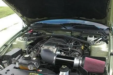

I have a custom Steeda STB (thanks to Casey4s on the forum). Not too sure what the weight is, but it didn't feel particularly heavy, and it looks great! I also have no idea if it will clear a s/c, but I just saw a pic of a Steeda brace that clears an aftermarket (midwest auto gear) plenum cover. Casey4s should be able to tell you what it feels like taking it off, since he removed it for a shaker hood set up!

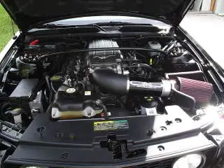

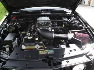

Here's mine:
I had the Steeda STB on my car for over a year and just recently took it off because it won't fit over my Saleen Supercharger. I checked around and there currently are no STBs on the market that will clear it.
As for how the car handles without the STB now, I honestly can't tell much of a difference - even during road racing. Just my 2-cents! :)

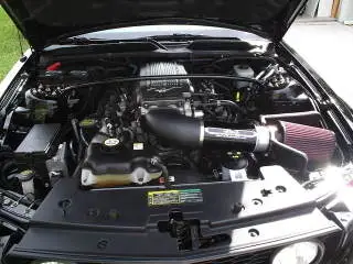

Bill, I was just reading over you're post, and I'm curious as to where you purchased your GT 500 STB from ??? At $48.43 ! I'm definitely interested in buying one for my Stang, as I also have the intake plenum cover..I'd also like to know, if the STB clears the hood blanket as well..Anyway, thanks for your feedback in advance..Rocky :nice:
Bought it from the dealer, ford part# 7R3Z 16A200 B, the hood insulator does rub the bar in 2 places but it keeps the insulation from rubbing on my manifold cover, I had no clearance problems with the hood, but a friend of mine had problems with the hood coming in contact with the bar, the solution was to put a washer on the back stud on each side under the bar, this angled the bar just enough to clear his hood.
