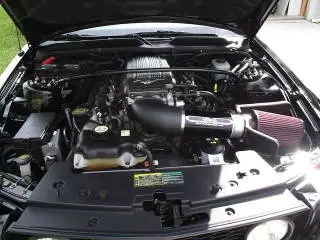

Here's the BMR tower brace clears by about an inch..zero rub on plenum cover or my cervini hood..
Damn, thats a SWEET underhood!!

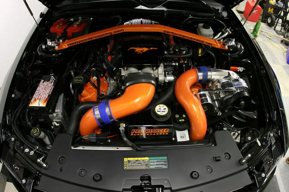

Where is your air filter? I didn't think Prochargers worked with STB's.
