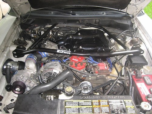

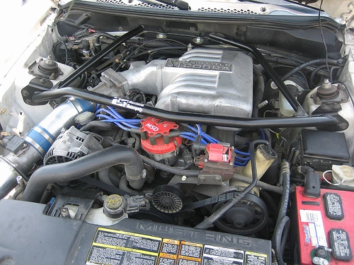

My Maximum Motorsports brace fits great and made a noticeable difference taking corners. '95 convertible with Xbrace, subframes and Cobra intake.

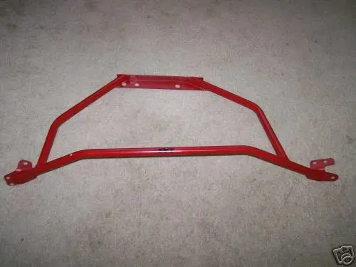

If you can find a 96-98 Cobra brace cheap they will work as well. You will need to pocket the corner between the intake and the brace on driver side about a half a inch. This brace works well with a KB on our cars too.
