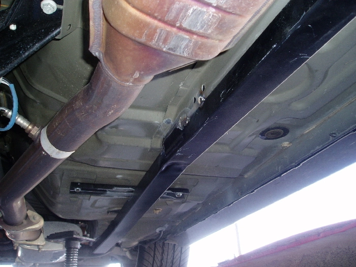

Maximum Motorsports. They are the best.

Best ones I think would be Full Length, weld in. Check out
maximum motorsports site. They will tell you everything you need to know.

Weld on Period. Bolt on was something for certain race classes.
as for full length or stnd length. The mm clear cats, but hang a lil lower. some of the other makes you can't run cat's because they run inside the frame rails.
I'm running stnd length and have no problems.

Do you have a pic of your SFC's? do you know if i would be able to run standard length with side exhaust?
