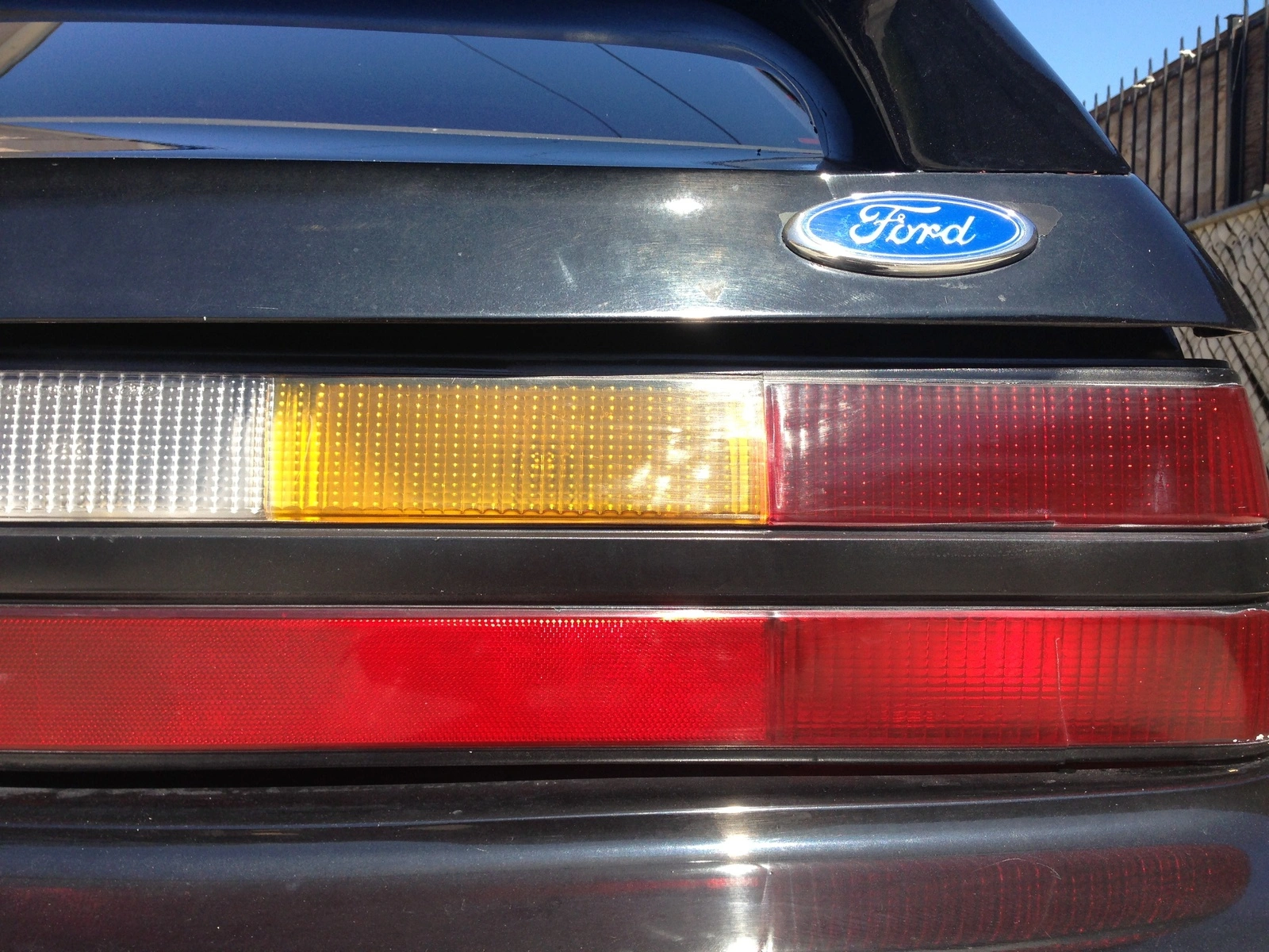

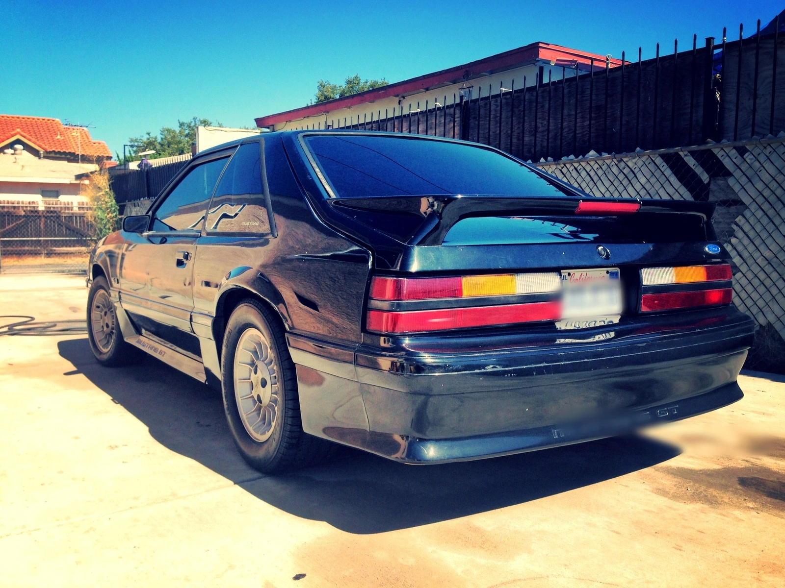

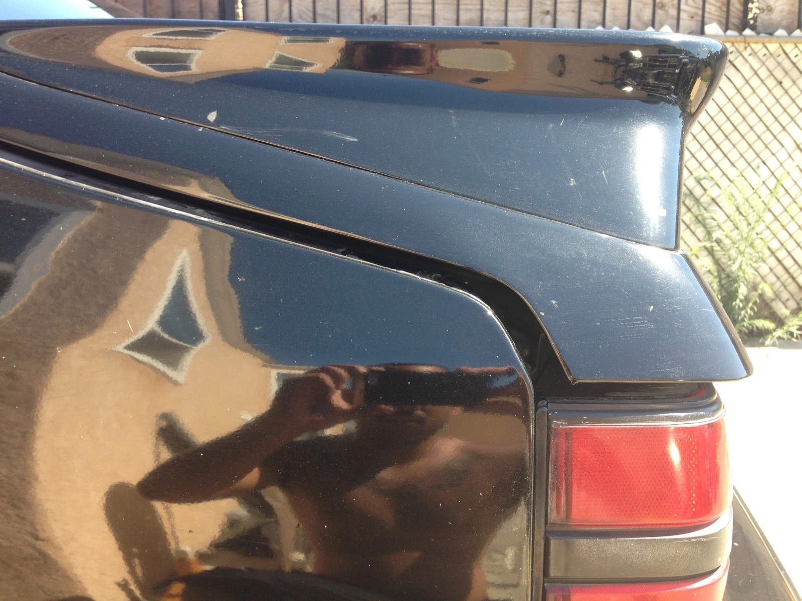

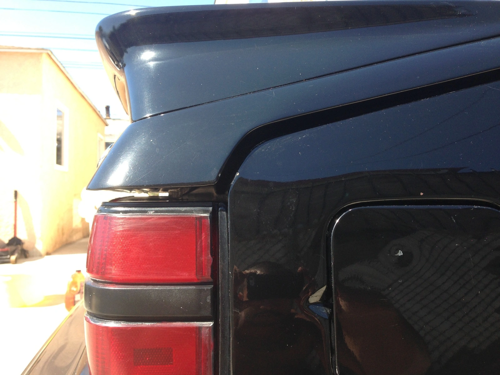

Hey all I have an 89 5.0 GT. I'm trying to figure out how to get rid of the 1 inch gap it has between the tail lights and the hatch itself. The car hasn't been in any accident, it closes all the way with the help of a little cardboard and electric tape where the striker bushing was. I tried removing the latch and re positioning it and all that did was get it to lock a little better.
It has a gap all the way up the body where the hinges are on the top. Has anyone else here dealt with this issue? Any help greatly appreciated. My fox looks ok for original paint wheels etc, but the trunk lid drives me crazy!

For starters, try loosening the hatch bolts and moving the whole thing forward a few mm (especially on the drivers side by the looks of your pic). The inner edge of your hatch is supposed to run parallel with the edge of your taillight where it meets the body. After that, try working with the latch and striker position a little to get it to close. Moving your latch further up into the hatch will allow you to close the hatch further before it locks against the striker.
The sad truth is, is that these cars were never right from the factory. No two hatches or trunk lids will fit a like. You'll just have to play around with it, going back and forth between the hatch bolts and hatch striker and latch until you get it to, or as close to right as you can. You should really just order a new striker bushing in the mean time. The cardboard tape set up is kinda ghetto and won't last.

Looks like I got an annoying task ahead of me. The passenger side if the hatch hangs over the body line, and the hatch is pushed out farther than the lights. So I think I will have to try a combination of a few things. I will report back once I work on it. Thanks fit the responses, and sorry for my late response. Helping family move all day long.
