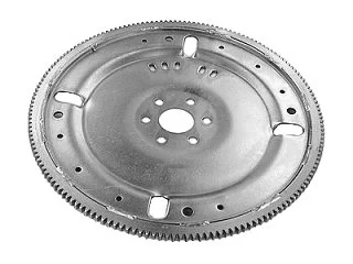

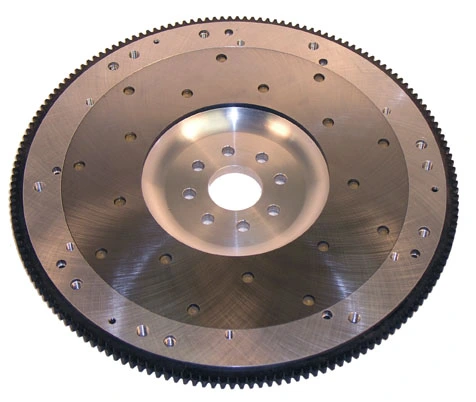

Z zZsKyZz Member Dec 1, 2005 503 0 17 Feb 6, 2012 #1 Feb 6, 2012 #1 Same as the topic: Do AODEs and T5s have the same Flywheel? I'm swapping my AODE to a foxbody T5, will the flywheel be the same or do I need to go buy a new one?
Noobz347 Stangnet Facilities Maint Tech... Er... Janitor Admin Dude Jan 4, 1985 43,467 21,649 234 Box behind Walmart Feb 6, 2012 #2 Feb 6, 2012 #2 Nope. They do not. Flywheels for manuals have a clutch surface while FLEX PLATES for autos do not. A manual flywheel for a Fox is 157 tooth. The flex plate for an auto is 164 tooth (same tooth spacing but the flex plate has a slightly larger diameter). Flex Plate" Fly Wheel: Reactions: zZsKyZz
