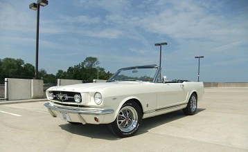

The original wheels were 14x5". Some early 65's were argent. They became charcoal. In early 66 (well, October 65) the rims changed from chrome to black, covered with stainless trim rings. In 67, they changed to 14x5.5".
Aftermarket versions (all-chrome) are available in 14x6", 14x7", 15x7", and 15x8".
I run 15x7 Magnum 500 and BFGs with 215 60 15 front and 235 60 15 rear. I know they aren't the same wheels, but those are available in this size. I would suggest going with 215 60 15 on all 4 or 225 60 15 rear. Thats if you go with 15x7. If you go with 14s the sizes would be different and more like 215 70 14.

I have a 65 vert and run those wheels 14 X5 with 205/70's up frony and 14 X7 W4"backspacing and 245/60's on the rear. To prevent the rear;s from rubbing the fender lip I had to lift the rear 2" I think withe this set-up 235/60's without the lift would not rub. I chose the 245's becuase I wanted the rear Tire OD to be very close to the front tire od. the closest I could were the 245's OD 28.8" and the 205/70 od - 25.6" and stay with BFG's all the way around. Unfortunatel smallest 14" tire BFG makes is a 205/70. by the way the car with 2" lift looks awesome.

The 235 60 15 on the rear of 65-66 does rub on some cars. Mine have only rubbed once and that was on a really wavy road, where it was like a roller coaster. I have slightly extended shackles (stay hidden behind valance) that raise the rear of my car about 5/8 inch and GT springs.
I bought a complete set of 15x 7 from Kentucky Mustang a few years back. They had the best package price I could find. The wheels have a 4.25" B.S. and I run them with 215 x 60's and the fit well and look great and the allow for lowering the car instead of raising it. Far better look for the classic Mustang IMHO.
I run 235 x 17 x 45's on my other car with 4.75 B.S. and they are as large as you can go without rolling the fender. If you try 235's in a 14 or 15 inch wheel they will rub because the wheel has less back spacing and if you get a custom wheel with 4.75 B.S they will hit the upper ball joint
