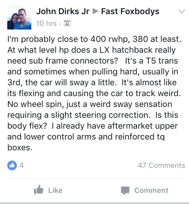

I'm long overdue for subs. Which kit should I get? I don't weld so I'll be getting a local foxbody specialist to put them on.
