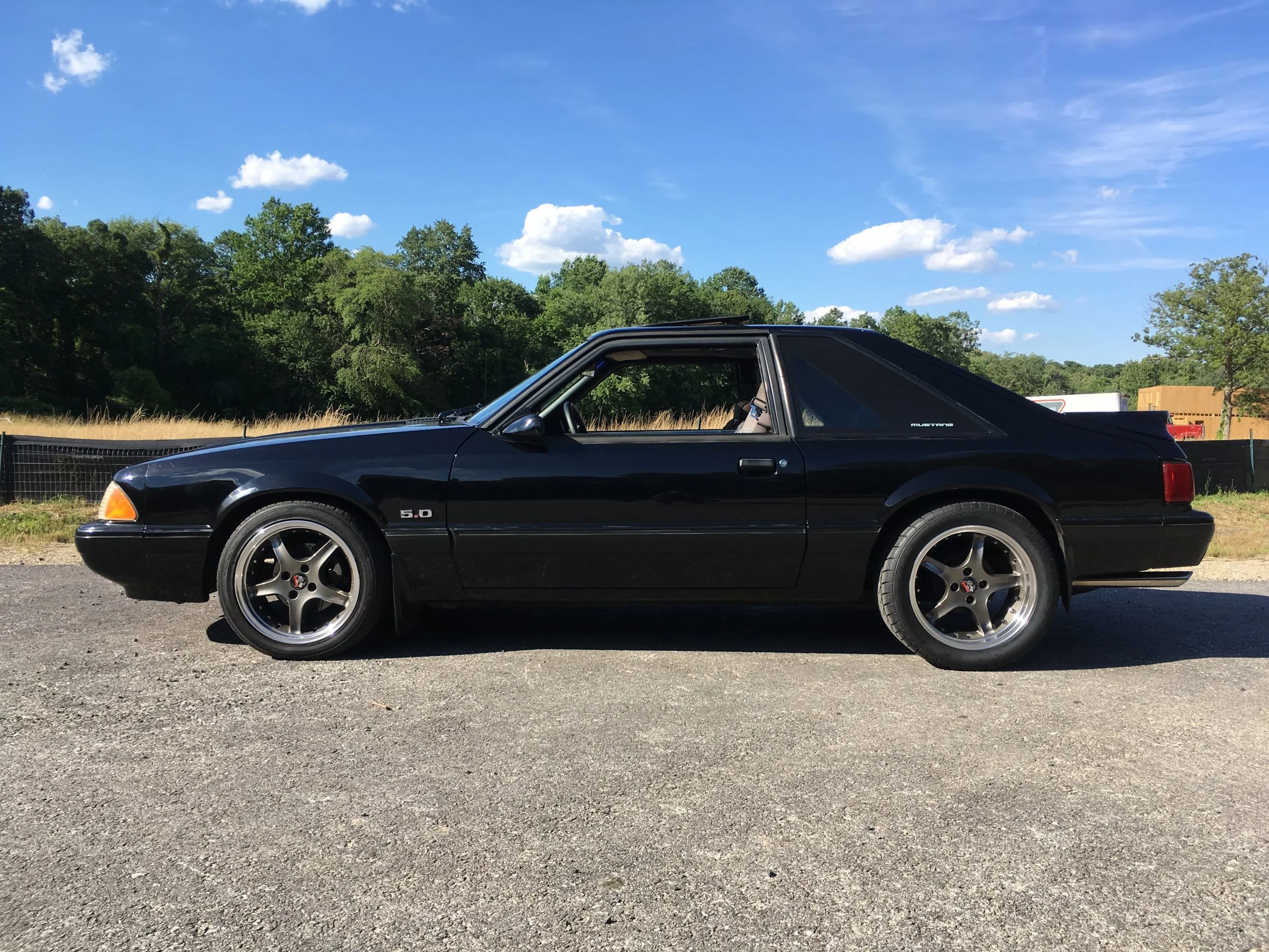

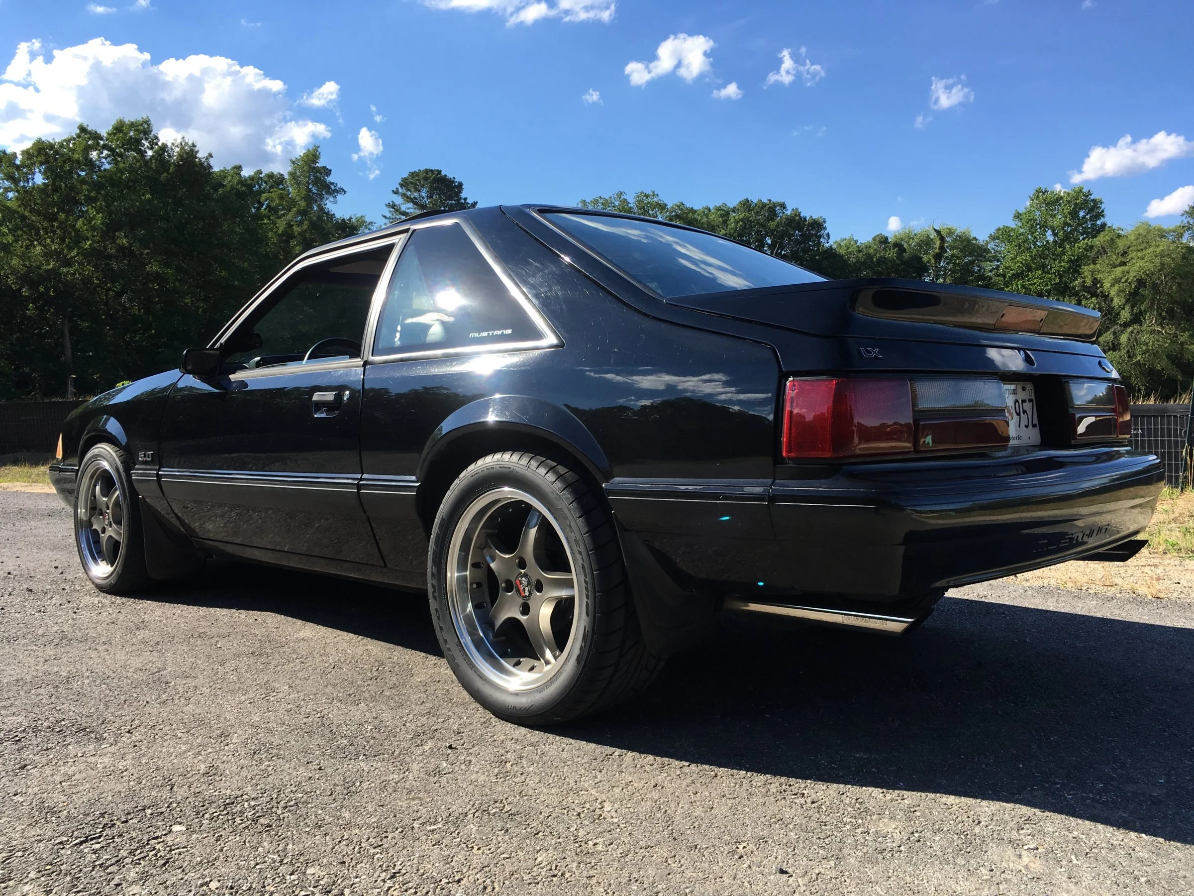

I painted the Mm subframes today. Drop it off tomorrow to be welded up. I also put in the Prothane front isolaters today. The front coils are SR Performance 1.5" drop. The rear are stock springs with isolaters still in. I think I got it just about right now. Drives very nice. I can't drop the rear or the 285's will rub.

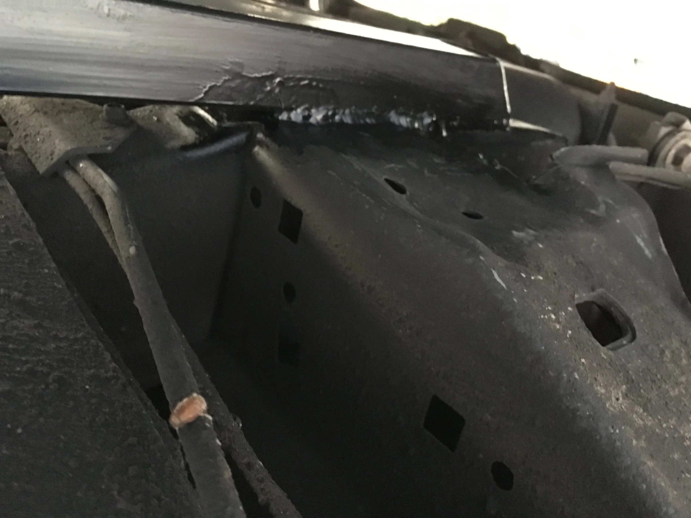

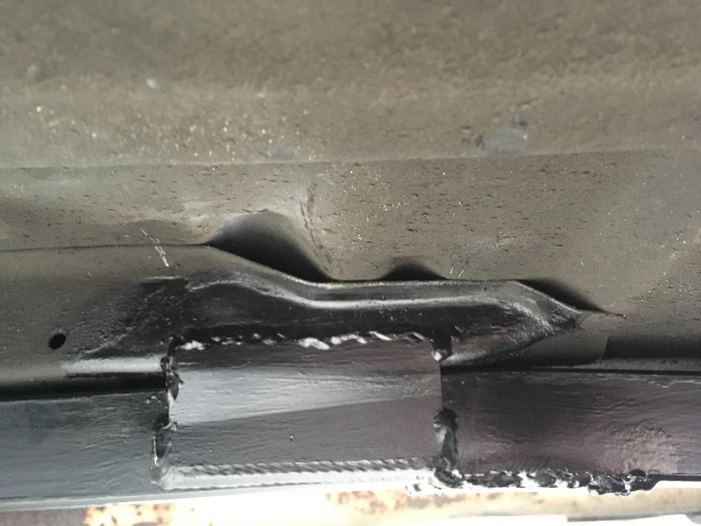

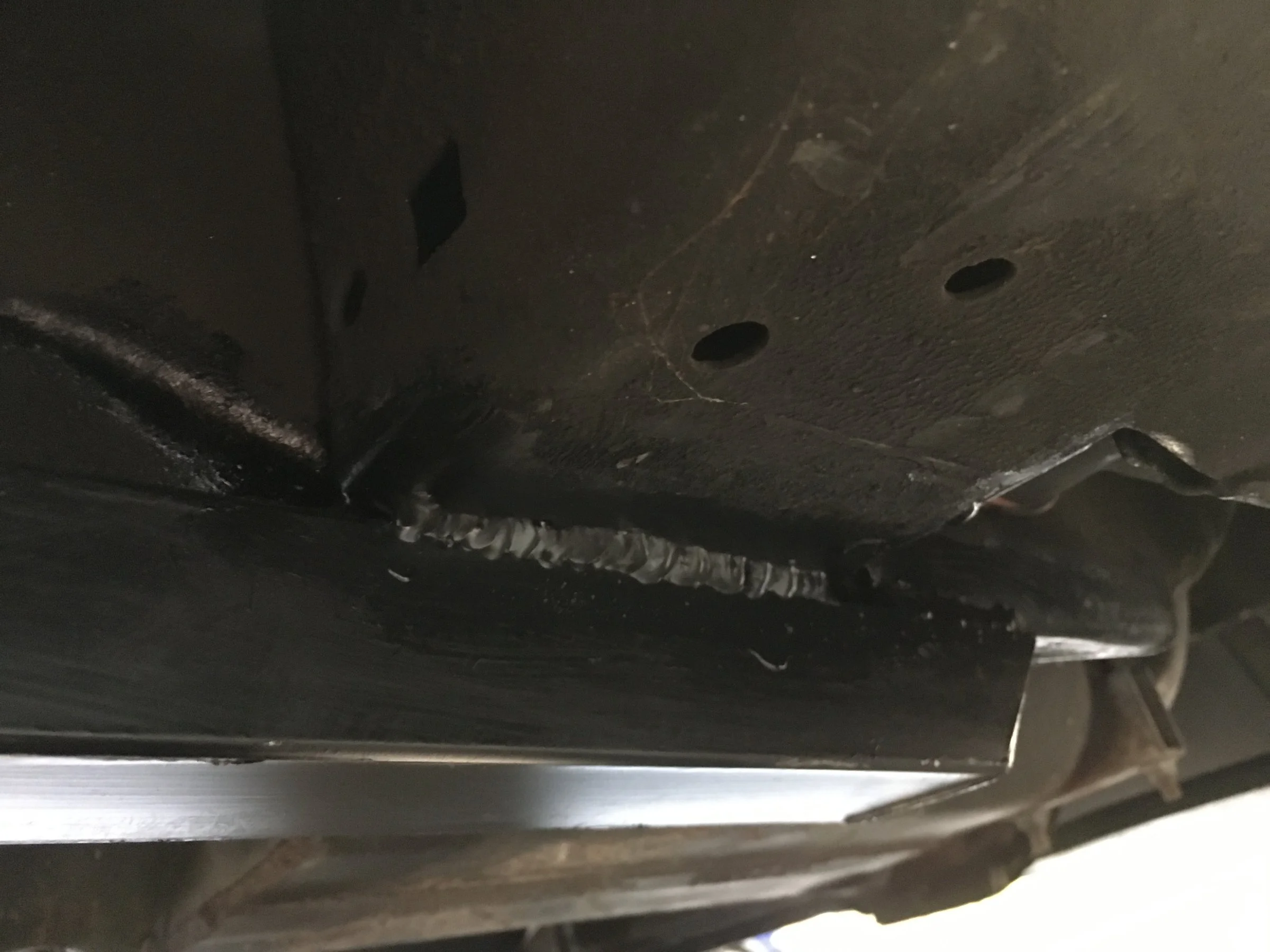

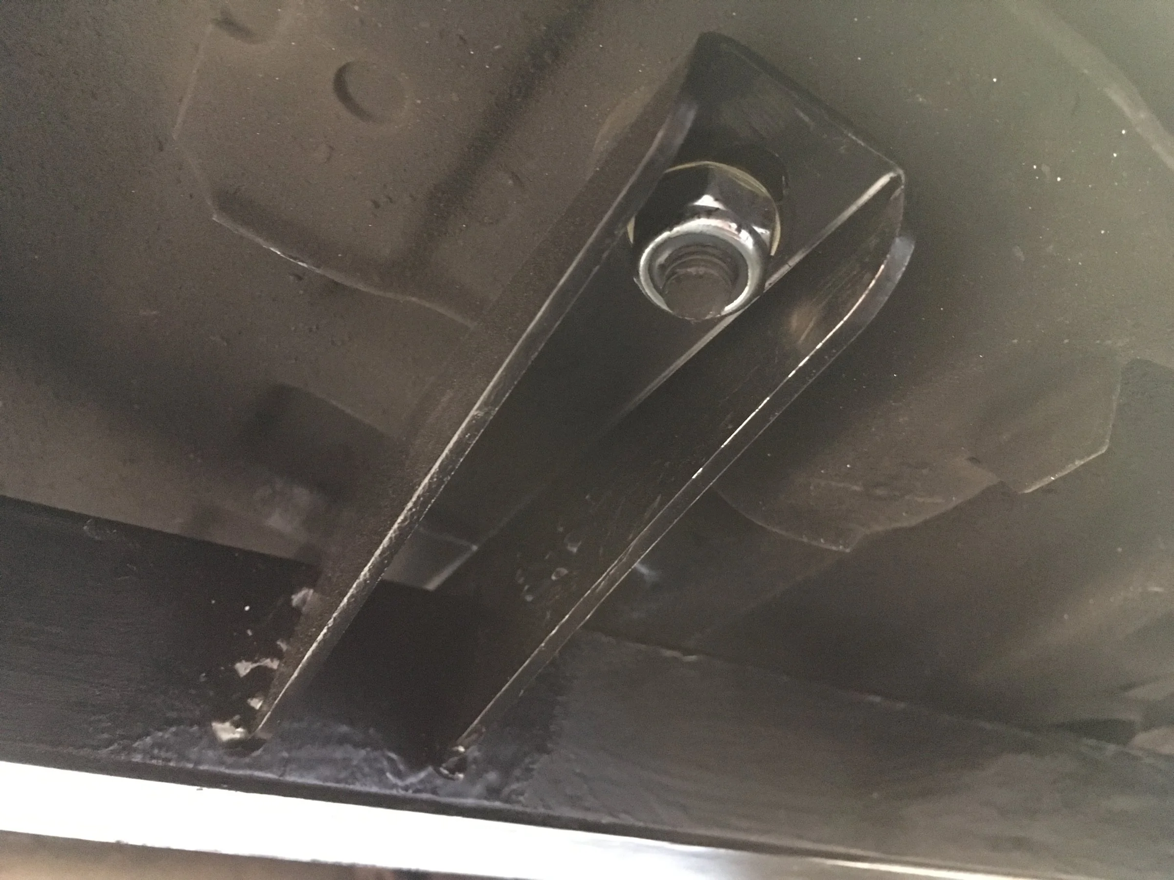

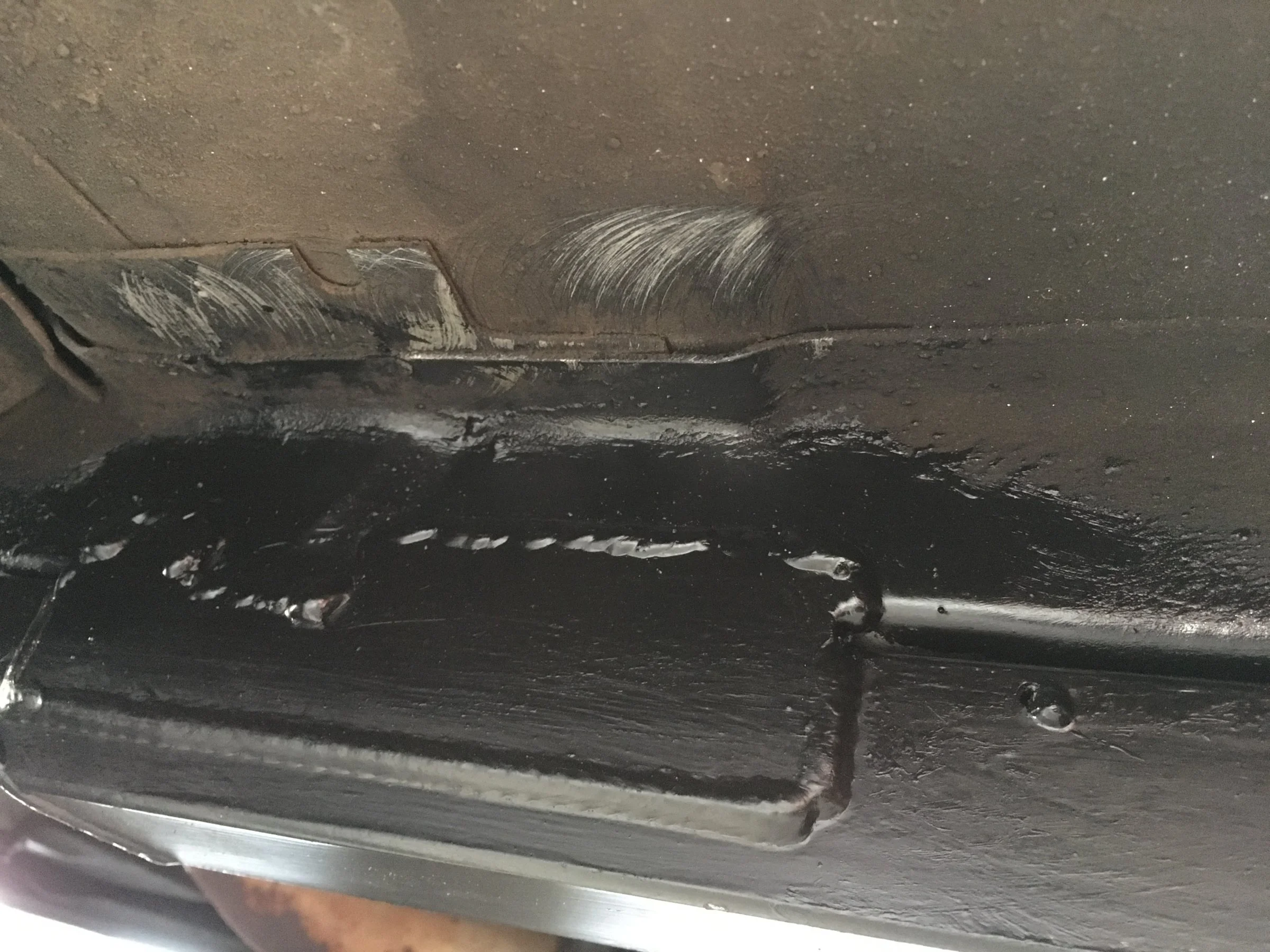

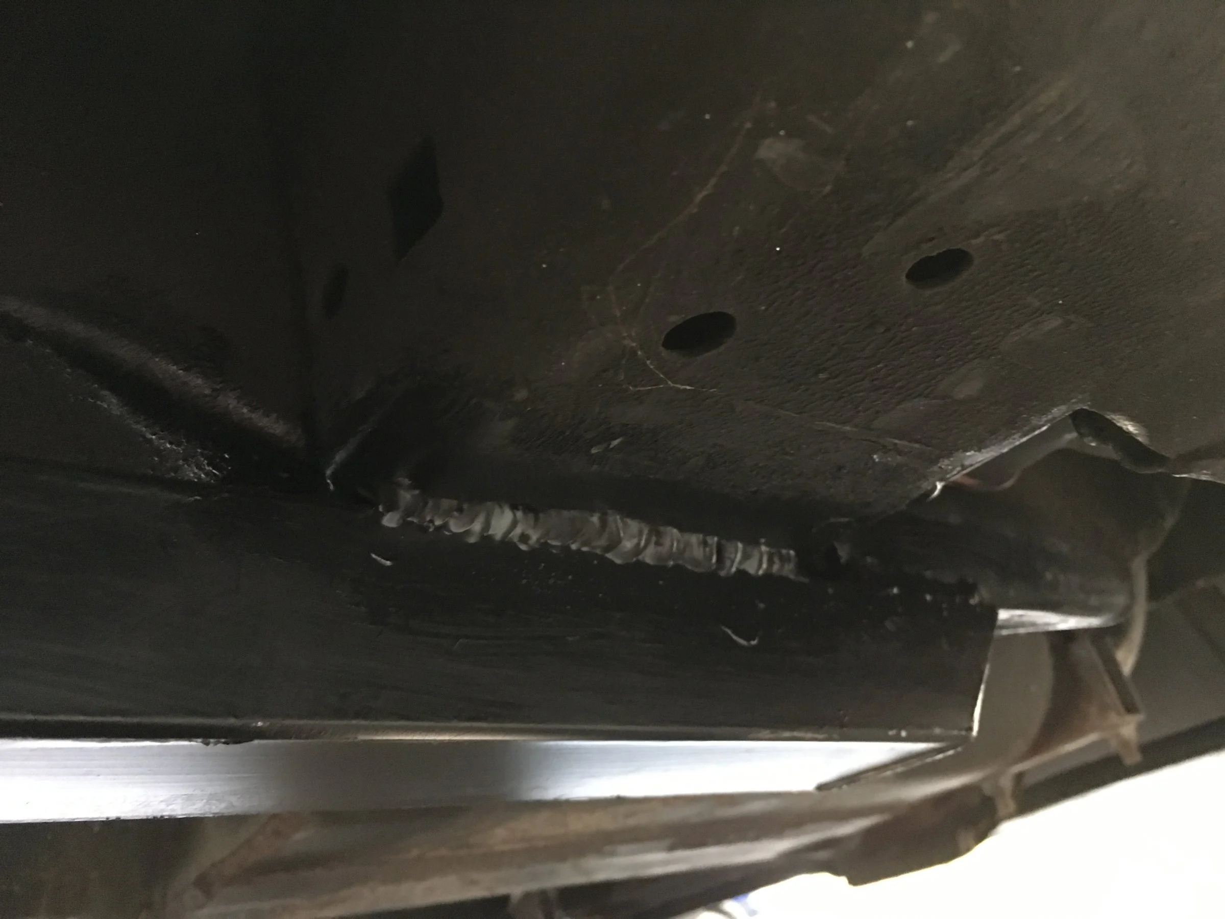

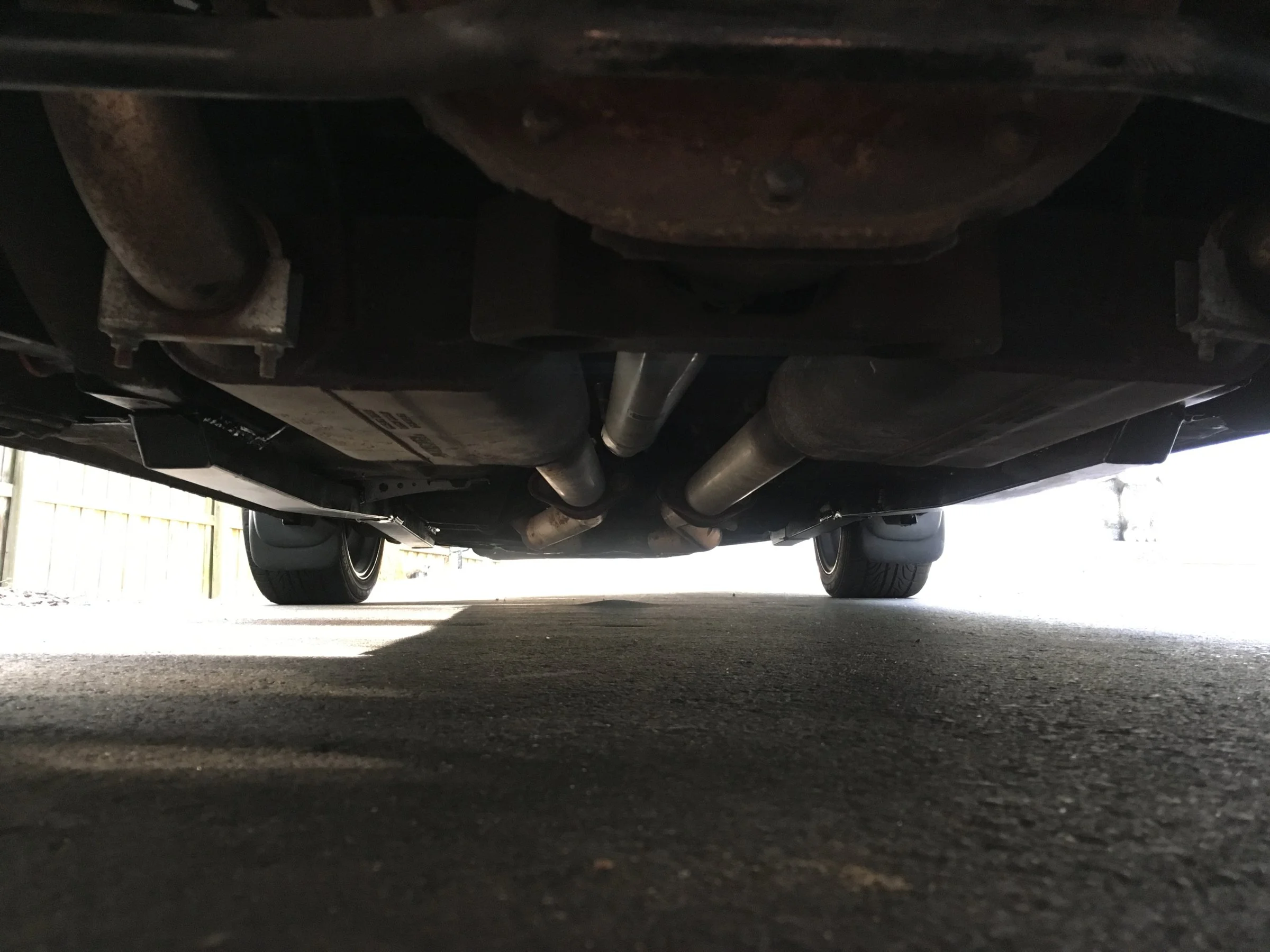

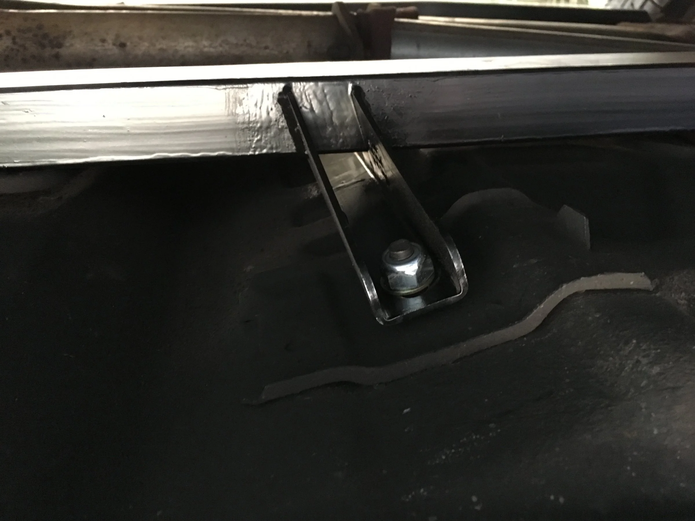

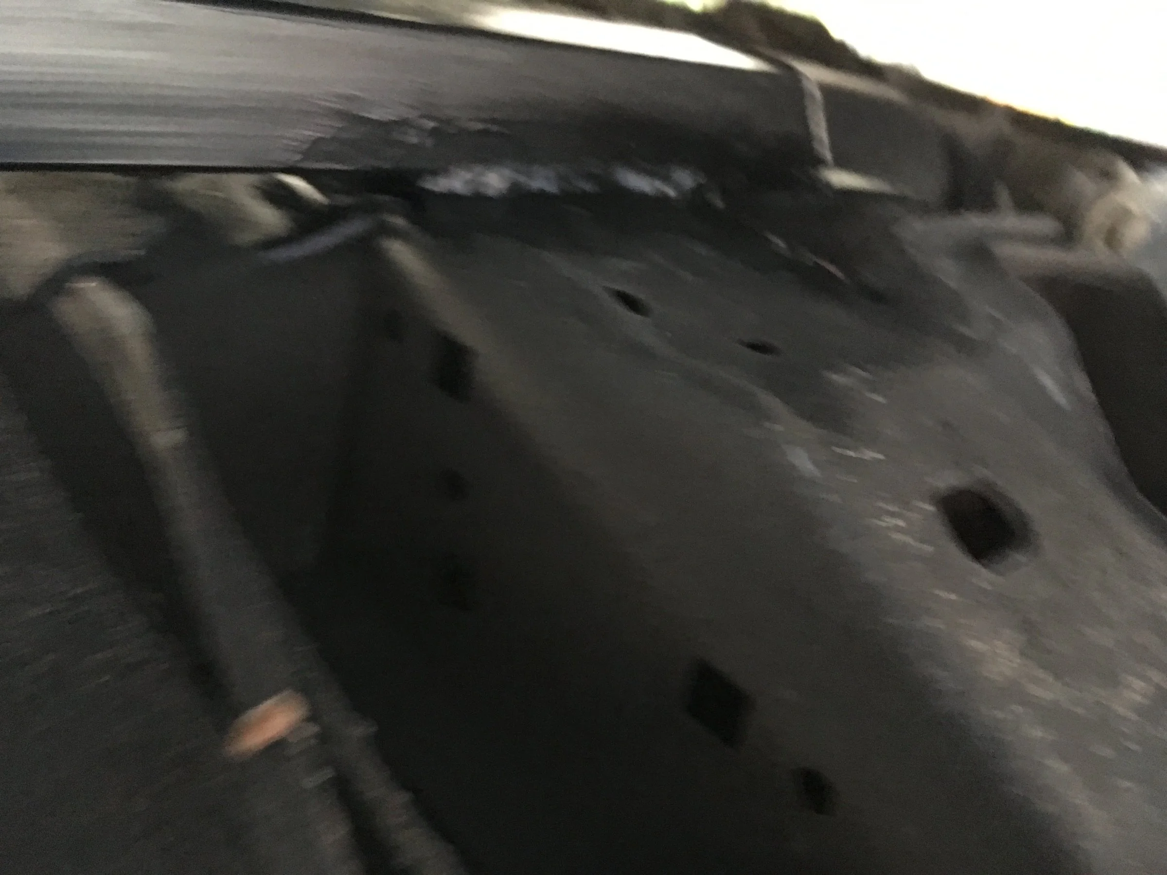

Report on the subframes installation;
The installer who has extensive experience with foxbody said my car's body had no signs of stress in the usual areas. He says these subframes will now prevent any of that in the future.
In driving the car I notice it feeling a little sharper when whipping side to side in sharp turns.
I described previously how it had felt squirrily in hard straight line acceleration. Almost like the rear end was slightly steering the car. That feeling is gone now. It pulls dead straight. I noticed something new as well. In full throttle 2nd gear pull, the right front lifts slightly higher than the left. You don't really notice it until you let off. Pull hard in 2nd to the redline and let off, when the front drops I can tell how the right side was up higher. So I guess the driveline tq is doing that. Anyway, I had not noticed that prior to the subframes install. I assume tq twist is no longer absorbed by a flexing unibody. Thereby I notice slightly more lift on the right side of the car. I only notice this in 2nd.
Here's some pics under the car. Sorry it wasn't on a lift I took them. Some pics are upside down
