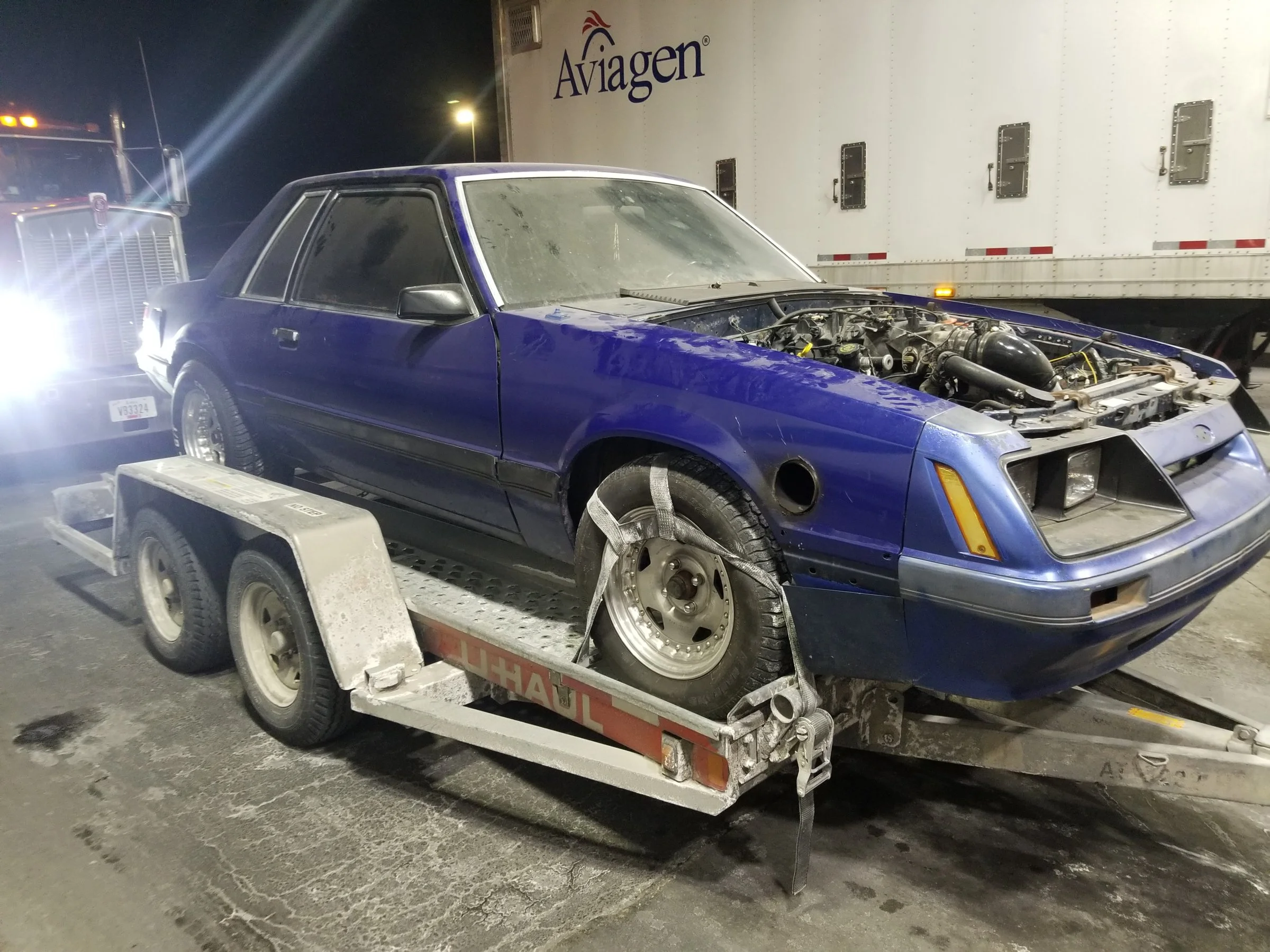

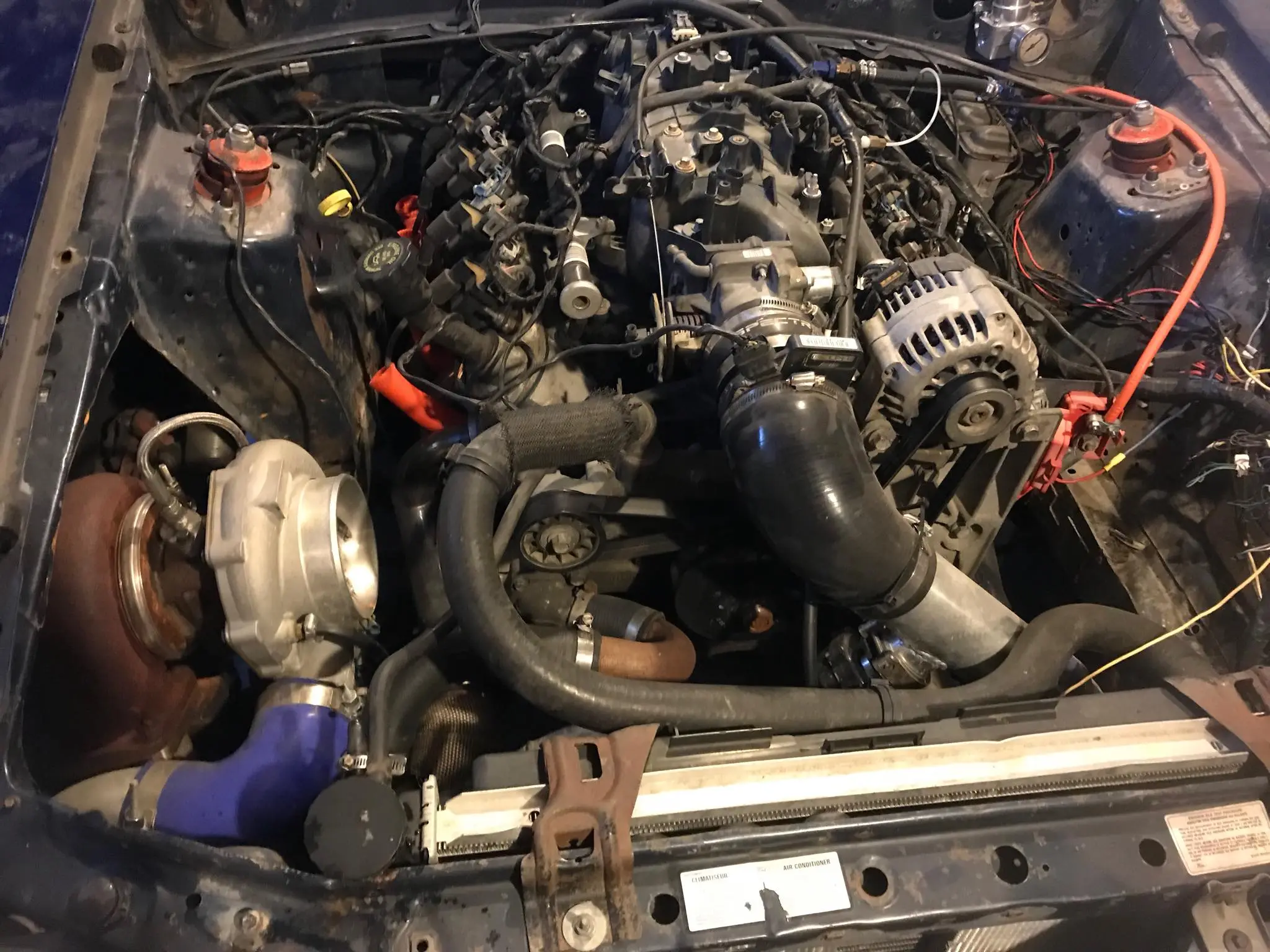

Already went with the turbo lol. It's going to be a street/strip but end up more or less on the strip with slicks
