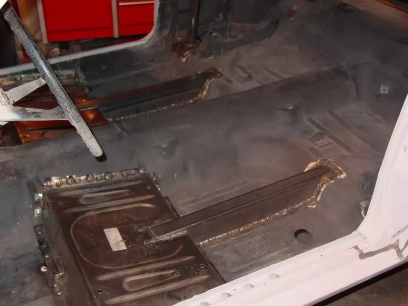

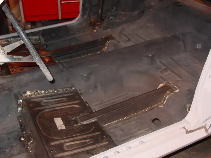

Hi, I just thought I'd post some pics of my subframe connectors and R-model rollbar installation pics. The car's really dusty right now, having been in the shop for what seems like an eternity! I got the idea for the subframe connectors from someone (can't remember exactly whose '67 racer had the same setup) on this forum (or maybe it was the Vintage Mustang Forum?). This is a great route to go for someone running side-exit exhaust, as ground clearance isn't diminished. Thanks again whoever made the earlier post with this idea, and here are a couple pics of my car. Initially I was nervous about having this done, but I think the welder did a great job...

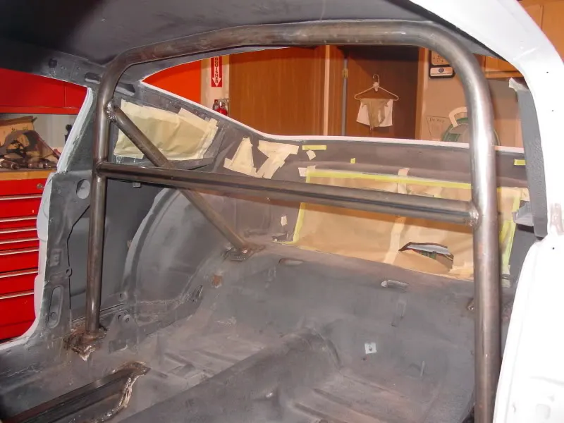

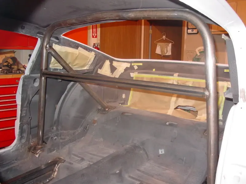

This image will hopefully be of use to someone, as I had a time finding an image of exactly where the rear bars were to be welded...

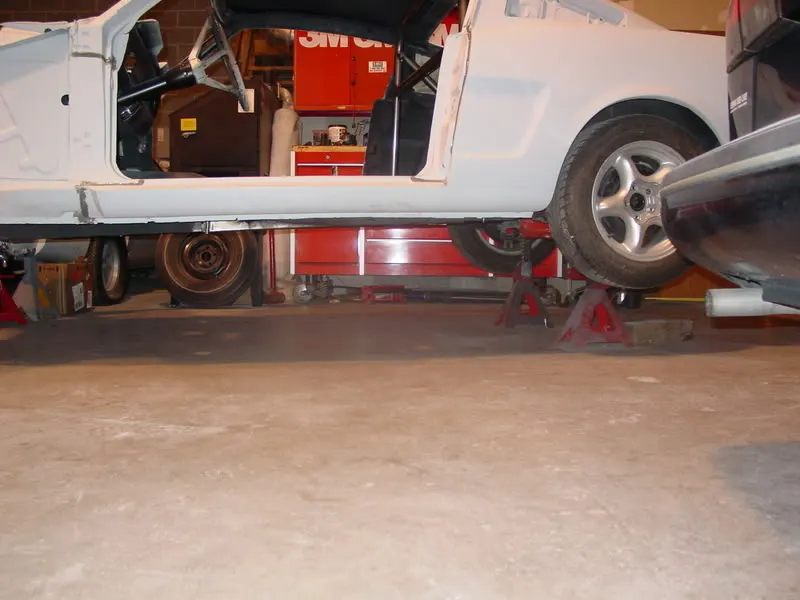

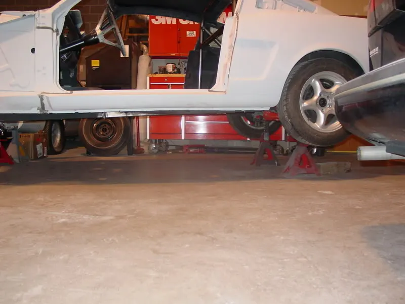

As you can see, plenty of ground clearance...

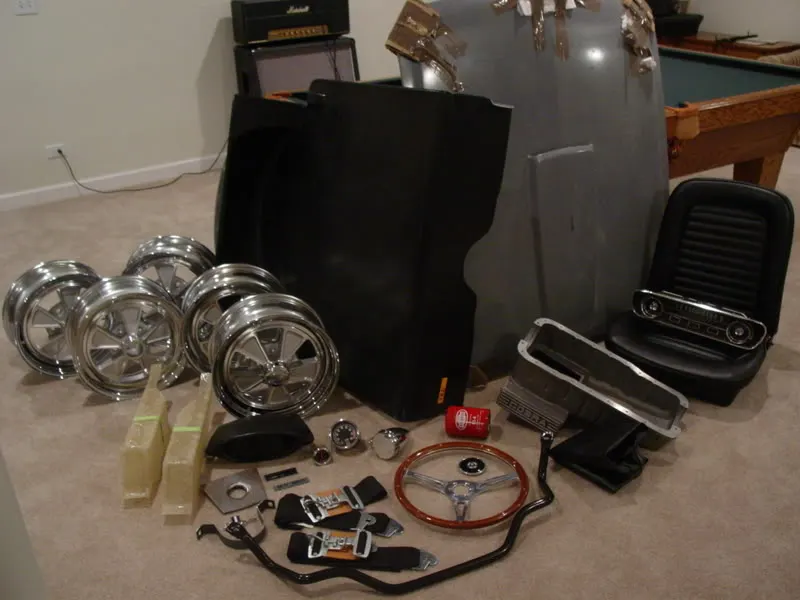

And here are some remaining Shelby parts from my dwindling parts stash that have yet to be installed on the car/engine. Still on my to-get list is a reproduction Goodyear Blue Dot tire for the spare...I've ordered BFGoodrich Radial T/As for the others. And as you can see, the car will be a street-model GT350 clone, as the rollbar is the only R-model piece I'll be using.

Hi, thanks for the comments! Hopefully others will find the pics useful, as I had quite a time finding exact rear mounting locations for the rollbar. Every pic I saw showing an installed R-model rollbar had the mounts covered with the fiberglass shelf.
And yes, I'll be running override traction bars. After receiving my original-style kit from Branda, I thought the brackets looked fairly weak, and heard of the benefits others have noticed in going with the spring rods outfits like Cobra Automotive offer. So I plan on getting a set of the 900lb spring rods, cleaning up the holes that were used to test-fit my Branda bars, and having better brackets welded in the car (thicker ones have already been welded to my axle housing).
