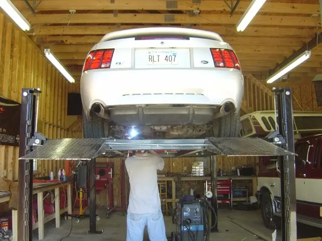

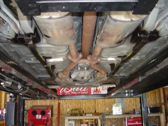

I just had the full length MM put on my 2003 GT Vert.
I got the powdercoated ones and sprayed the welds with paint.
Cost was $165 to install and the guy had a drive on lift and did an excellent job.
He also had to remove the stock bolt on subframes that come on verts.
What a difference BTW!

What are the benefits of subframe connectors?
Is this something that can actually be felt from the driver's seat everyday or only at the track(hard launches, etc...)?
Finally where do they get welded into exactly, I've seen pictures of them but was never able to visualize where they go.
