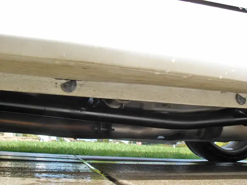

I got Global West full length subframe connectors. My handling around corners is incredible and it's one mod that I can FEEL the difference (unlike adding a cold air intake)
You can see my SFC below.
