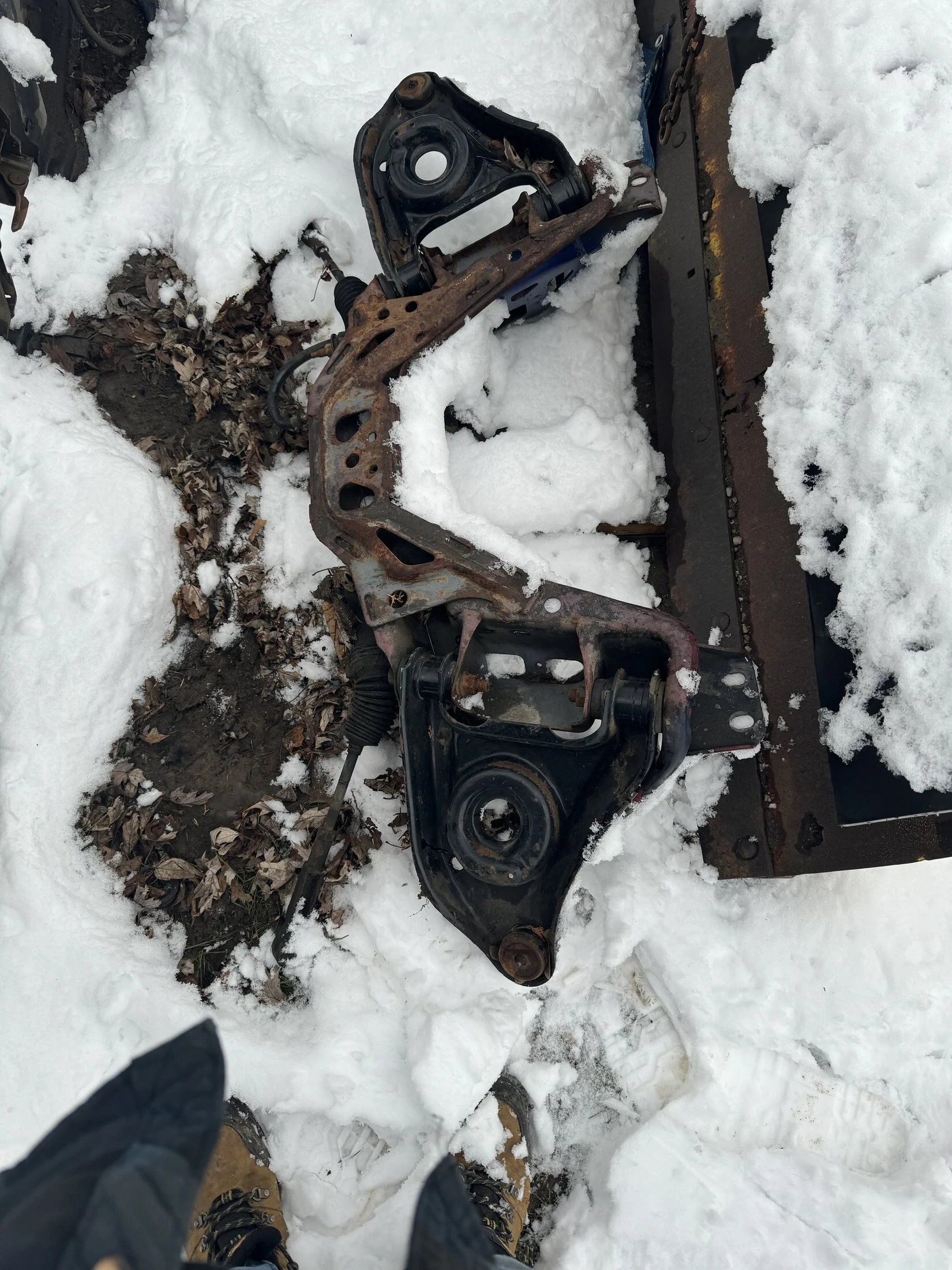

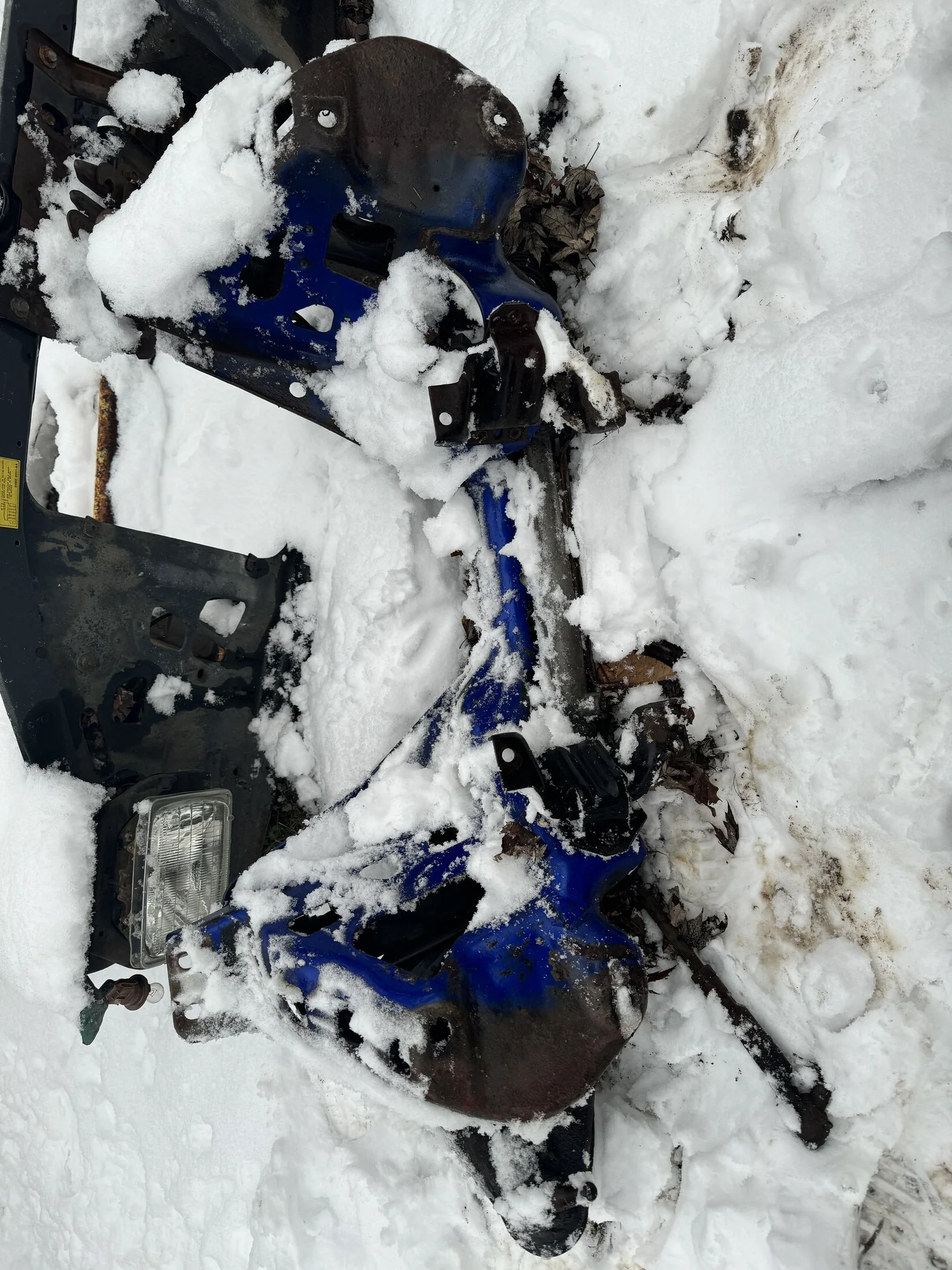

Ok! I have a 1989 4 cyl. donor car. Is it true that the control arm mounting points are narrower? I would like to run longer control arms from the sn95 chassis on my fox and this I think would help me. My fox already has sn95 spindles paired with 2000 cobra r brakes. I am attempting a...

That is a V8 k-member.

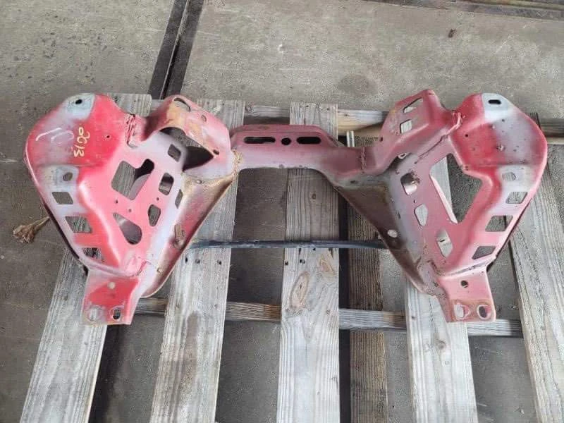

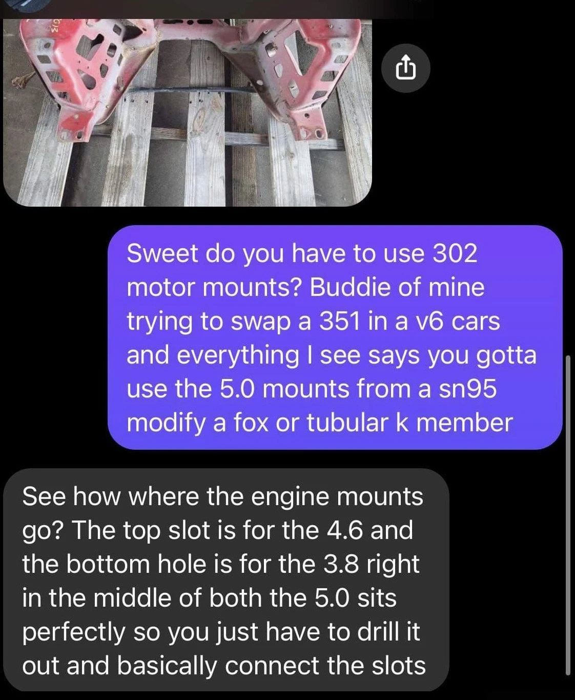

So updated possible info? my buddy actually found a swap done somewhere in KY on FB and decided to do some questioning. This is what he found. I plan to buy another car, a 94 GT but that has now been pushed to Thursday so who knows. but we plan to try this... For... Science!

Engine location fore/aft differs as well. The 302 sits further forward so not sure that alignment would work out ideally. You might run into issues with shifter alignment? Crossmember and exhaust fitament and driveshaft lenght.
But I’ve never done this so I can’t comment for sure so I could be over blowing the risks.
Questions I’d be asking that guy who did it is if the engine was in the right spot so that trans lined up perfectly. The exhaust fit right, and other parts fit where they would normally sit on a 302 car. Just hate to see going that route turn into more work down the road.

Yea still trying to get more info, but after reading some of the threads in here i figure why not try and some testing along the way. I just removed the engine mount bolts, trans was already previously removed, exhaust is removed, and me and my buddies spent some of saturday picking at it. basically short of the fuel lines its ready to pull, but before i do i want to measure exactly that. Got any thoughts? i was thinking of measuring between the crossmember and the back of the bell as it is still bolted to the engine with a brand new clutch, either that or i was considering using a string, (i know ill have to have the engine level or where it would be with transmission mounted)

Got word from the guy who did it, says he used an adjustable transmission crossmember from lmr, because it did move it back slightly but not much just couldnt get the holes to line up just right. also says he used the same driveshaft so im assuming it cant be too much. But i intened to find out. i just pulled a measurement from the center of the front of the bell to the center of the front of the crossmember and came up with 14 3/4. Well see when i moch up my old 5.0 block with bell tomorrow and re measure!
